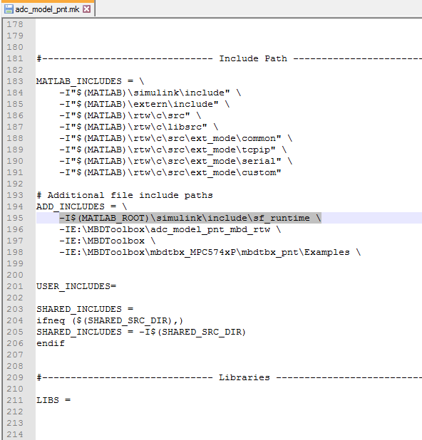

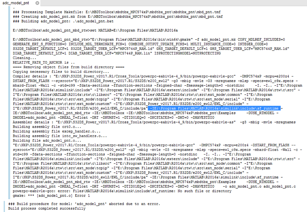

I found one including path doesn't have double quotes with it, which causes build procedure failed. Can you help on how to correcting the *.mk file? Thanks.

fixed it within mbd_pnt.tmf
ADD_INCLUDES = \
|>START_EXPAND_INCLUDES<| -I"|>EXPAND_DIR_NAME<| " \
|>END_EXPAND_INCLUDES<|
