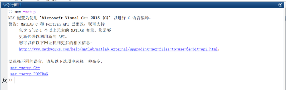

Recently, after my win10 OS update to version 1803, and the matlab2017b , KV MCU toolboxs reintalled. The bad news came from inoculation. just open the example model, the matlab windows shows warning message as attached pic. and i get many error messages when compling the model ,as the addached txt file. refresh simulink library can not clear this warning messages. and the matlab2017b , KV MCU toolboxs runing well before OS update & reintalled.

This issue only can be solved by upgrade the matlab to version 2018a in my pc. I'm trying different Win10 versions(such as version 1803,1709, 2016 LTSB), different c++ compiler(vs2015pro,WSDK10,WSDK7,MinGW64) with matlab2017b,the error is same.  I don't know why.

liuqimin
Hi Daniel
    The screen shot just like this:
 Thanks!

Daniel_Popa
Hi liuqimin‌
If you type mex -setup in your MATLAB command windows what do you get ?
