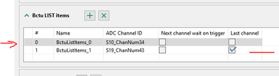

Each trigger can command either a LIST or a single channel and can store the results either directly in the BCTU_ADC_Data_REGs or inside some FIFOs. In case you are using lists, then you can convert up to 3 channels at the same time, of course, if they belong to different ADC HW instances.
For example, in the below settings, the internal Trigger 2 stores the results inside the ADC Data regs, and starts conversion for a list, on the instances (ADC_2 and ADC_1, because of the Adc TargetMask being 0b110 - on the ADC_0 is disabled) starting from the Conversion List Index 0.
The Bctu List can be seen below. It will start the ADC_2 CH S10 and the ADC_1 Channel S19, and then the triggers will stop, because of the second idem marked as "Last channel"
