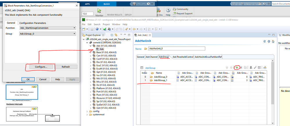

Now, the S32K3 toolbox uses an external configuration tool in order to make all the settings for the peripheral required in the application, while the MBDT blocks read the configuration and display only the information required for the selected Function. For example, the Adc_StartGroupConversion will update the Group dropdown display options with all the Groups configured in the AdcHwUnit in the external configuration tools.
In order to add more such ADC Groups, you have to open the ADC Block, press the Configure Button and open the Adc Component. Here you can configure all the required channels from your application.
Once you are happy with the settings, you can save and close the external configuration tool and press the Refresh Button in the ADC block. The refresh action will read the new configuration and update the dropdowns with the new values, if any.

1. The above screenshot shows the EB Tresos, but you can choose also the S32CT which comes already with our toolbox.

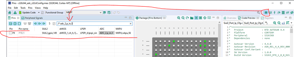

For each pin muxing, in the case of S32CT, you shall use the graphical pins component as shown below (while for the EBT is the Port component). The Pins component can be opened by pressing the first button on the top right-hand side. From this component, you can assign the pins to each peripheral according to your application requirements. For example:
The next step is to enable the channels you want to convert in the Adc tab, as you already showed us in the picture.

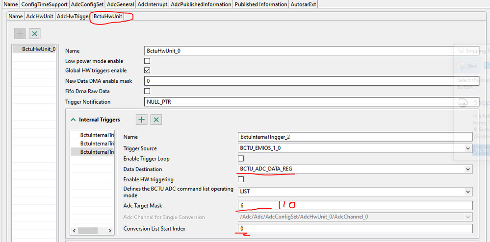

Because you have mentioned that you want the BCTU to start the conversions, well, I strongly suggest starting by our s32k344_adc_ctu_ebt. Since the 1.1.0 release, you can open, see how the blocks are being used to trigger such conversions, even you don't have EBT installed. You shall enable the ADC to be controlled by the BCTU using the Adc_EnableCtuControlMode, then you start the conversion of a particular trigger (of course, set in the S32CT).
Each trigger can command either a LIST or a single channel and can store the results either directly in the BCTU_ADC_Data_REGs or inside some FIFOs. In case you are using lists, then you can convert up to 3 channels at the same time, of course, if they belong to different ADC HW instances.
For example, in the below settings, the internal Trigger 2 stores the results inside the ADC Data regs, and starts conversion for a list, on the instances (ADC_2 and ADC_1, because of the Adc TargetMask being 0b110 - on the ADC_0 is disabled) starting from the Conversion List Index 0.

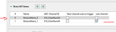

The Bctu List can be seen below. It will start the ADC_2 CH S10 and the ADC_1 Channel S19, and then the triggers will stop, because of the second idem marked as "Last channel"
