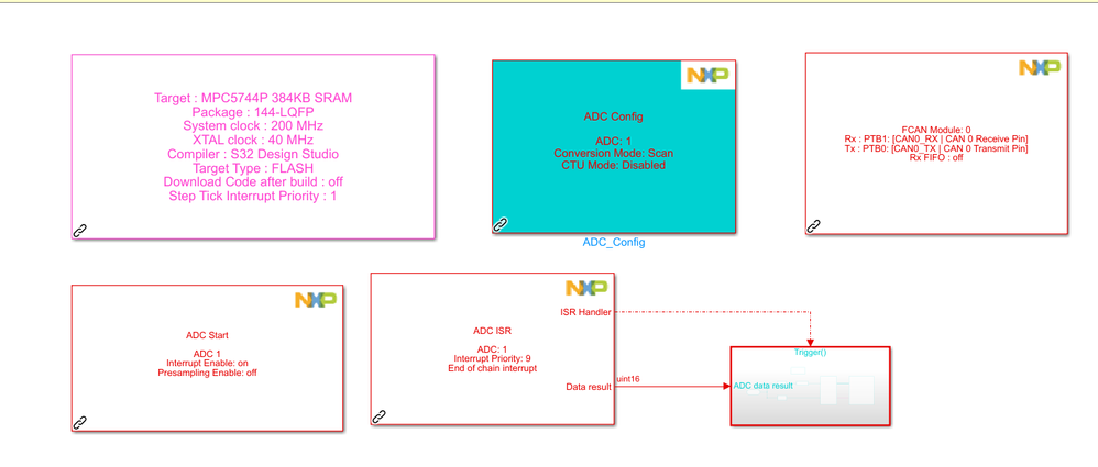

Generate code,but there is no main.c file.   what is wrong?

Hello ChenBowen,
After you build the model, two folders are generated in the matlab's current location:
  • model_name_mbd_rtw;
  • slprj.
Inside the first folder ('model_name_mbd_rtw'), you are going to find the generated files. Here you are going to find the mbd_main.c.
