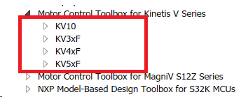

As far as i know, the Motor Control toolbox for Kenietis support the following MCU's family:
However, after discussion with NXP team they told me that the KV11 series is an extension to KV10 with more memory and peripherals, and therefore it might simply work with the the MC toolbox using the KV10 blocks.
I understand from this that I can use the TWR-KV11Z75M with the MC toolbox for Kinetis.
Could you please, you members of the NXP MBDT community confirm that it is possible. Thanks in advance.
For the moment I can not say if this statement is true or false, as I do not know if all the peripherals are the same and are mapped to the same addresses, if the clock structure is the same, etc. We will have to investigate if our toolbox  works 'out-of-the-box' with KV11. I will get back to you once we test it out and I can be certain that it either works, or it does not. Please note that this will take a while as our team is at the moment in the midst of a MPC574x release and all the focus is on it.
