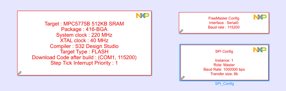

Now I want to use MBDT to establish model to configurate MPC577B and MC33771C. I want to know if there is a corresponding tool chain now.
If there is not tool , could someone provide a demo or description file to help me build model to connect MPC577B and MC33771C?

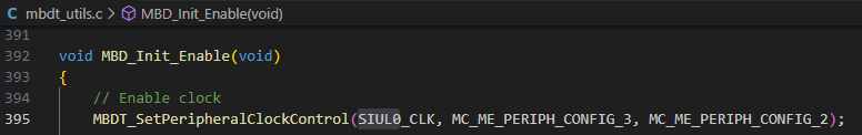

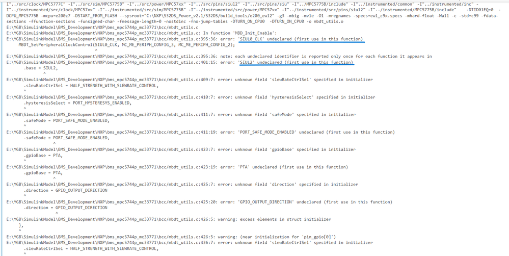

I followed the way  MPC5744P-and-MC33771-Configuration and download the archive, and open the model in R2022b.The model could be built when the MCU is set to MPC5744p.However,when the MCU is set to MPC577B,an error is displayed in the next picture.
I found that 'SIUL0_CLK'used in 'mbdt_utils.c' declared in the file of 'MPC5744P_features.h'.I think I should use 'MPC5775B_features.h' in my project.But  'SIUL0_CLK'  undeclared in the file of 'MPC5775B_features.h'. So should I modify the file of  'mbdt_utils.c'?What should I do to modify the file?

I followed the way  MPC5744P-and-MC33771-Configuration and download the archive, and open the model in R2022b.The model could be built when the MCU is set to MPC5744p.However,when the MCU is set to MPC577B,an error is displayed in the next picture.4.png2.png
What should I do to finish the build when the MCU is set to MPC5775b?
