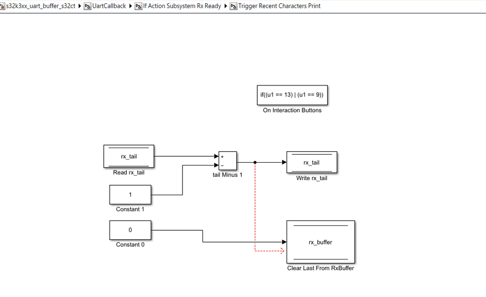

Dear NXP,
When I open the example project - "s32k3xx_uart_buffer_s32ct", it always gets this error.
I don't know how should I revise it, please help me.
Thank you

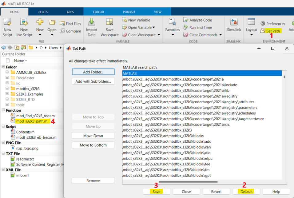

Adrian_Gherca
The problem might have several reasons, but here are two things to consider in order to solve it:
1) It looks like the Matlab path has some issue. Please clear the Matlab path from the "Set Path" window and run the "mbd_s32k3_path.m" script again.
2) You are using the latest MBDT toolbox 1.5.0
Please make sure that you are opening this Simulink model in Matlab R2021a or a newer version.

SuperBeginner
Hi @Adrian_Gherca ,
Thank you for your reply.
You solved my problem, thanks.
