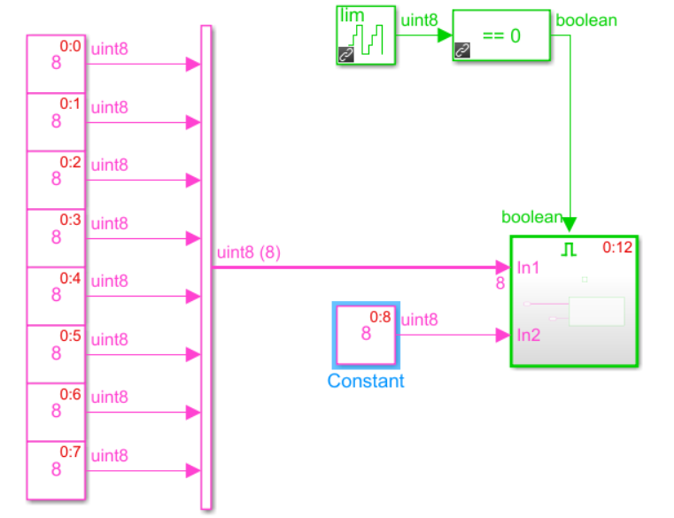

I am trying to send multiple CAN messages with different period. I am using the counter limited block and compare to constant block to periodically trigger the CAN send message block.
I could periodically transmit multiple messages with the same period by using this method but I am having trouble transmitting multiple messages with different period. I could transmit multiple messages if I didn't use the above mentioned two blocks but then the messages were not being sent periodically. Is there another way to transmit the message periodically? Moreover, I could not use Tx complete block with the above-mentioned method. I have attached my model which was created by 2018b.

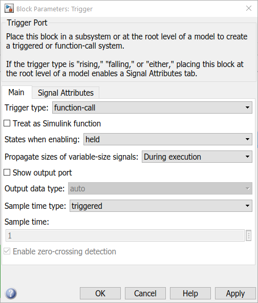

So for you to periodically transmit messages (or do anything else for that manner), you have 2 choices:
  • software scheduling (via software timer)
  • hardware scheduling (via hardware timer)
One of the many approaches available for software scheduling is what you did here - enabling a subsystem via a signal (limited counter in your case). The software approach I'd recommend is described here, in a nice article wrote by gramirezv.
If you want to go for the hardware triggering, you can do this by using a PIT (periodic interrupt timer). You can find it in our toolbox, under Core and system blocks -> PIT Timer.
You can set the period here, and trigger a subsystem with this block.
Note that inside the triggered subsystem you'll have to use a trigger block, setting it's type to function-call.
