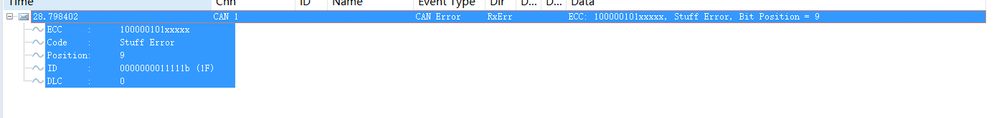

I used the the Simulink Block of MPC5643L from NXP,I wanna use it to realize the CANbus comunicatin,the External crystals is 8MHz,The target of the Baud Rate is 500K:
 I use the CANalyzer to display the signal,but the Error shown as below:
My configure about the CanBus Configure shown as below:
My calculation about the Baud rate as below:
Baud Rate=8000,000/(Prescaler*(1+(PROP_SEG+PSEG1+2)+(PSEG2+1)));
So i fill in the parameter,Prescaler=1,PROP_SEG=5,PSEG1=5,PSEG2=2,
Is there some thing wrong about the calcaulation?

Hi edenli,
Something is wrong with the formula. It's not working on my side neither. Why do you want to change the XTAL frequency ?
