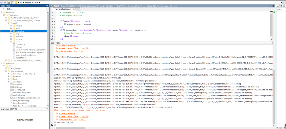

When I use matlab s32v234 evaluation board to simulate face detection, the following problems occur:
make[1]: Leaving directory '/g/Matlab2018file/codegen/exe/face_detection/build-v234ce-gnu-linux-o'
make: *** [/g/NXP/VisionSDK_S32V2_RTM_1_3_0/s32v234_sdk/build/nbuild/platforms/coordinator.mk:57: allsub] Error 2
Who can help me, thank you

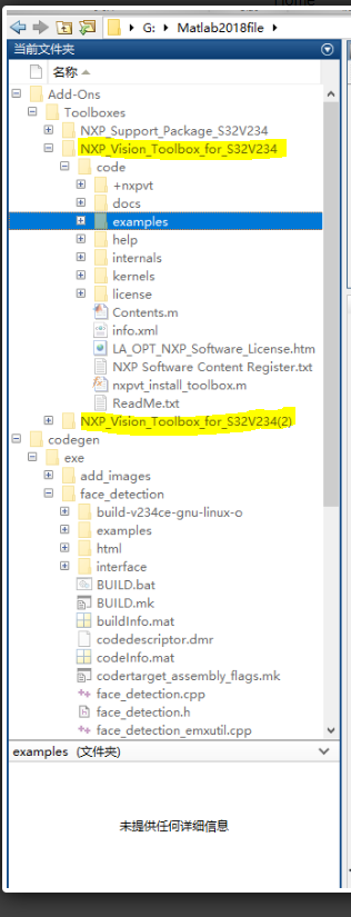

iulianbulancea

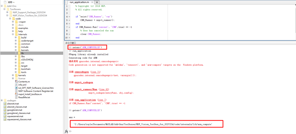

Hi [email protected]‌,
It looks like you have the toolbox installed multiple times. Please remove the highlighted toolboxes from the image below ,by uninstalling them or just by deleting them, and install the toolbox again. You can not have more than one instance of the toolbox.
Kind regards,
Iulian Bulancea

iulianbulancea
Kind regards,
Iulian Bulancea

751301185
Hi,Iulian Bulancea
As you said,uninstalling them or just by deleting them, and install the toolbox again,Still so.

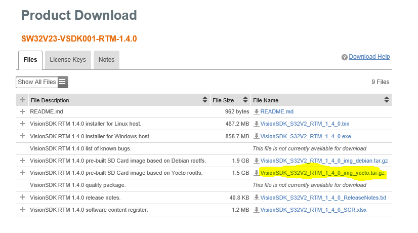

You must install Vision SDK version 1.4.0 and update the environmental variable S32V234_SDK_ROOT. You can follow  the steps from this tutorial AI and Machine Learning Course #1: Hardware and Software Setup. You should find the old releases on the Previous tab.
Let me know if you have any issues.

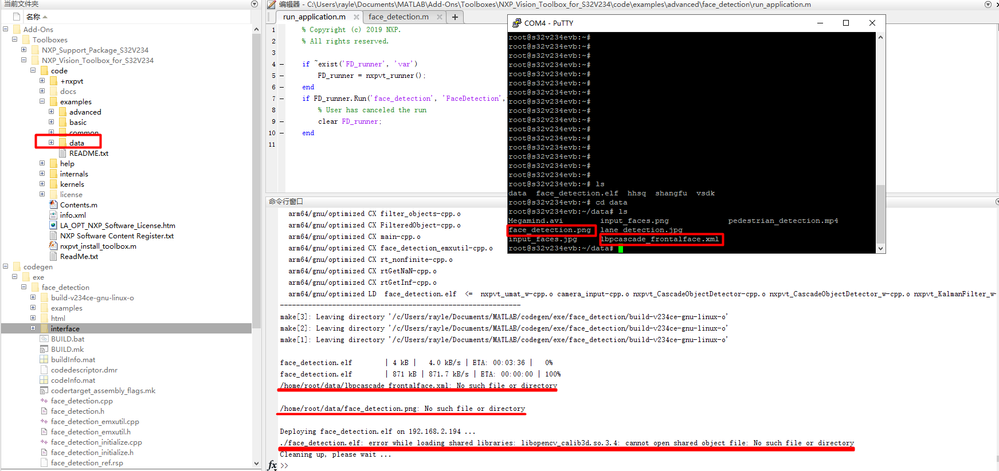

face_detection.elf | 4 kB | 4.0 kB/s | ETA: 00:03:36 | 0%
face_detection.elf | 871 kB | 871.7 kB/s | ETA: 00:00:00 | 100%
/home/root/data/lbpcascade_frontalface.xml: No such file or directory
/home/root/data/face_detection.png: No such file or directory
Deploying face_detection.elf on 192.168.2.194 ...
./face_detection.elf: error while loading shared libraries: libopencv_calib3d.so.3.4: cannot open shared object file: No such file or directory
Cleaning up, please wait ...
13,111 Views
iulianbulancea
In the config structure you have to pass the files needed by the function to run on board. Also, for the advanced examples, the config requires a field called Input, which will be the input of the face_detection function. In your case you can have the following config:
config.MakeJobs = 8;
config.Optimize = true;
config.TargetIpAddress = '10.171.74.173';
config.Deploy = true;
% first entry from the tuple is the name of the file you want to copy to board and is relative to the current path of MATLAB
% second entry from the tuple is name of the file on board and is relative to the elf location
config.ExtraFiles = { ...
{'../../data/face_detection.png', 'data/face_detection.png'}, ...
{'../../data/lbpcascade_frontalface.xml', 'data/lbpcascade_frontalface.xml'}};
params.input = 'Image';
params.file = 'data/face_detection.png';
params.demo = false;
params.KalmanFilter = false;
config.Input = params;
nxpvt_codegen('face_detection.m', config);
Instead of calling the nxpvt_codegen function you can also run the script run_application from the face detection example folder. The script fills in the config structure by asking a list of questions.
Kind regards,
Iulian Bulancea

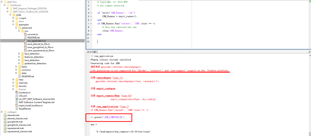

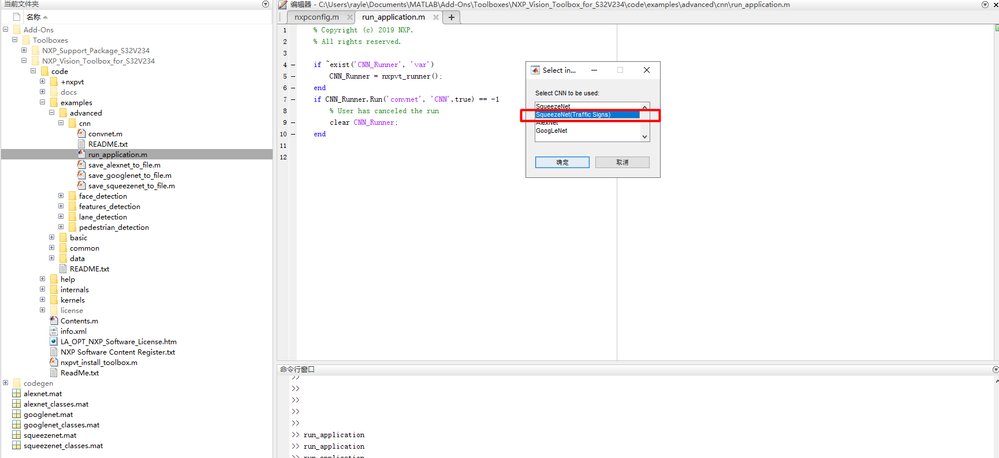

751301185
Hi,Iulian Bulancea
I have some more questions:When I want to run on a board using CNN,Code generation is not supported for 'mkldnn', 'tensorrt', and 'arm-compute' targets on the  Windows platform.
What's the difference between using MATLAB to develop apex algorithm and using S32DS?
I really hope you can answer for me.
13,109 Views
iulianbulancea
You should not define the environmental variable ARM_COMPUTELIB or set it to empty from MATLAB using setenv('ARM_COMPUTELIB'). This way the toolbox will use its one ARM compute library.
Kind regards,
Iulian Bulancea
13,109 Views
751301185
Hi,Iulian Bulancea
I am very confused.
13,109 Views
iulianbulancea
The toolbox supports code generation for cnn for MATLAB R2018b, R2019a, and R2019b.
Kind regards,
Iulian Bulancea

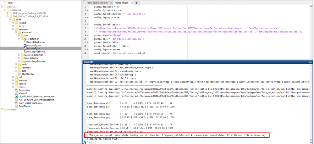

751301185
Hi,Iulian Bulancea
  nowadays,./face_detection.elf: error while loading shared libraries: libopencv_calib3d.so.3.4: cannot open shared object file: No such file or directory
How should I load this library in MATLAB?
13,109 Views
iulianbulancea
You should use the Yocto SD card image provided with Vision SDK 1.4.0.
Kind regards,
Iulian Bulancea
