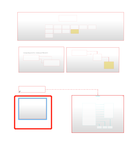

The model I configured is as follows. In addition , can you help me see if the control framework is reasonable, and now the motor is not working very well.
Jiantao Li
 I have another problem here. I wrote a motor control program according to the official example. What is the difference between 1 and 2 in the selection card below? When I select 1, set the step size to 0.001 in the simulink configuration. When the priority is lower than the FIFO interrupt (the period of the FIFO interrupt is 100us), the freemaster can't communicate with the MCU. When the priority is greater than the priority of the FIFO interrupt, the freemaster can communicate with the MCU. When I select 2, the freemaster cannot communicate with the MCU. In addition, when I set the step size to 0.1 in the simulink configuration, the program control effect is very poor, the current loop control program is placed in the FIFO interrupt processing, what is the relationship between this PIT0 interrupt?

The Timer options selets the Step Tick peripheral. If you select the PIT Channel 0, the toolbox automatically configures the Pit peripheral to trigger an interrupt every step time set in the simulink configuration, in your case 0.001s. What you are facing with the FreeMaster interrupt is normal, those interrupt requests come at higher frequencies. As am example, you can compare timings from our Motor control examples in our toolbox.
When select the Timer as Supressed, this means that the toolbox will not trigger automatically the step function, so you will need to add a timer interrupt, and inside it to put your model. Right now, when you select Supressed this means that probably your app is not even running right now.
