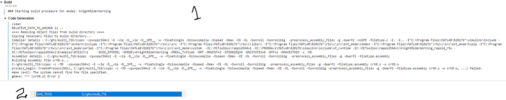

I fixed the issue (from the previous ticket/case) with the 2017b (hotfix was helpful). But after that, when I am trying to build my code, it throws an error for the gmake crt0 (in the attachment). I don't know how to solve the issue. I tried reinstalling the compiler, the RappID application. But nothing works. I keep getting the same error.
Hardware - MPC5643L
Compiler - GrennHills Multi v7.1.6
Simulink - 2017b
Please let me know if some information is missing. But I am totally stuck with this issue and unable to proceed.

Daniel_Popa
Hi raghurajappa
The toolbox has been tested (at release date) with the following compatible compiler toolchains.
Compiler Support
The following compilers are supported and have been tested with the following releases.
Compiler Supported
Release Version
Green Hills MULTI for PowerPC
V5.1.7
WindRiver DIAB
V5.9
CodeWarrior Development Studio for Freescale MPC5xxx
V2.8
CW for MCU
V10.6
Since the toolbox has non been updated since then, our suggestion is to pick the versions suggested in the Release Note document.
Hope this helps!

Daniel_Popa
The system variable is set correctly. The problem is with GHS toolchain that has changed the layout between versions. It would be helpful if you could pick up the same version used for validation. Newer versions of the GHS will require multiple changes in the toolbox in order to be supported including changing the code generation. Due to complexity of the change that is not a candidate for a hot-fix.
Thank you!

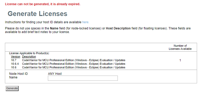

raghurajappa
Thank you Daniel. The issue I have is my Codewarrior compiler licenses have expired and I am unable to get an extension :smileysad: (I am not sure if you can help with this) If you can help me with this, I would be pleased to try Codewarrior.
In the meanwhile, I made a request to GHS for the previous version.
The same error for Codewarrior 2.8.
5,596 Views
Daniel_Popa
Hi raghurajappa‌,
Unfortunately, i can't help your the CodeWarrior licensing. It is not under my control.
Are you saying, you have tried with CW 2.8 and you got the same crt0 error ?
