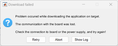

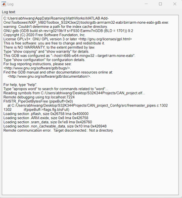

Thank you for the information. I updated my toolbox to 1.4 and found CAN peripheral for CAN0 was already configured with steps you had mentioned. However after configuring the JTAG pins I'm not able to download the .elf on target and get an error which were not there with the 1.1 version. I'm attaching a screenshots of the error and log. Could you please look at it and let me know if I'm missing anything?
I'm using PE micro multilink debugger for programming the board.

Recently, I've had to configure the CAN peripheral in a few models so I would like to double-check some things regarding the configuration:
- Are the CAN pins updated to the MR-CANHUBK344 mappings?
- Is the CanController enabled?  (inside CAN_43_FLEXCAN > CanConfigSet > CanController)
- If i remember correctly, the CAN0 is configured for CAN FD by default, so keep that in mind.

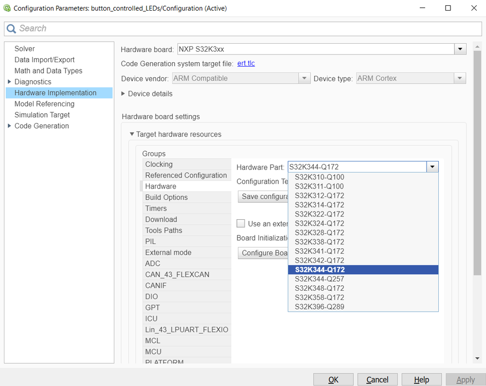

- The error you encountered could be caused by the wrong hardware part being chosen in the following menu: (S32K344-Q172 should be selected for the MR-CANHUBK344)
Regarding the downloading process for the code, we would need you to provide more details, if the points mentioned before do not fix the issue.
- Which external configuration tool are you using?  S32 Config Tools or Elektrobit Tresos?
- How exactly is the PEmicro connected to the board and if the P7A connector is used?
- What are the steps you followed when configuring the JTAG pins?
RobertV
