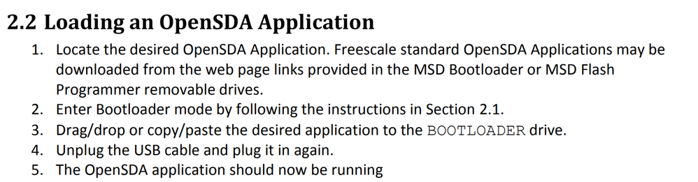

As luck would have it, I bricked the board today.  It would not come out of bootloader mode.  It wouldn't take new bootloader firmware.  It wouldn't respond to the Mutlilink Universal programmer.  It wouldn't respond to the Kinetis software to fix the bricking.  12V power, USB power, didn't matter.  I messed with it for 3 hours, pouring over every post about a bricked device.  I was finally able to get the BOOTUPDATEAPP to take, then it took the 1.19 bootloader firmware, now everything is working great on USB power and OpenSDA is programming from Simulink.  Like it's fresh out of the box again.  I'm so happy slash worn out.

I'm back to a bricked unit.  It worked so well all day.  I left my computer for a while and it went to sleep.  When I came back, the board was no longer communicating.  I unplugged and replugged and it would no longer recognize the device.  I immediately started in boot mode and dragged over the BOOTUPDATEAPP file.  When I cycle the plug it isn't recognized by my computer and I get 2 green LEDs and 1 red LED.  No SDA drive on my computer at all.  I've tried it 3 times just to be sure.

Yes everything seems to be working great on this board.  I didn't do anything that we had not tried previously so I'm not sure why it works well now but I'm happy that it is.  I may try again with the second board to see if I get the same results.  Thank you for your support!

On the S32K144EVB there are four jumpers, that have the following functionalities. Probably the one you are referring here is the J104.
If I have my EVB drive folder open, I can watch the mot file populate.  No other files change.  LASTSTAT says "READY”.  The board has a flashing green LED (D2) but, strangely, after 5 flashes, the red LED (D1) and the RGB (D11) flash twice very quickly at the same time, then the pattern repeats.
The led D2 is the Led Status Indicator for the OpenSDA. The actual states of the led patterns are described in the Table 2 (page 8) of this file https://www.nxp.com/docs/en/user-guide/OPENSDAUG.pdf .
I would suggest to reflash the OpenSDA Applicationas explained by the section 2.2 from the referenced document.

Error with either firmware:
COPY CATCH: The system cannot find the file specified.
: >> C:\MATLAB\Projects\Power Control Module\adc_pdb_trigger_s32k14x_mbd_rtw\adc_pdb_trigger_s32k14x.mot
Can't download the file to the board.
LASTSTAT.TXT says "READY"
