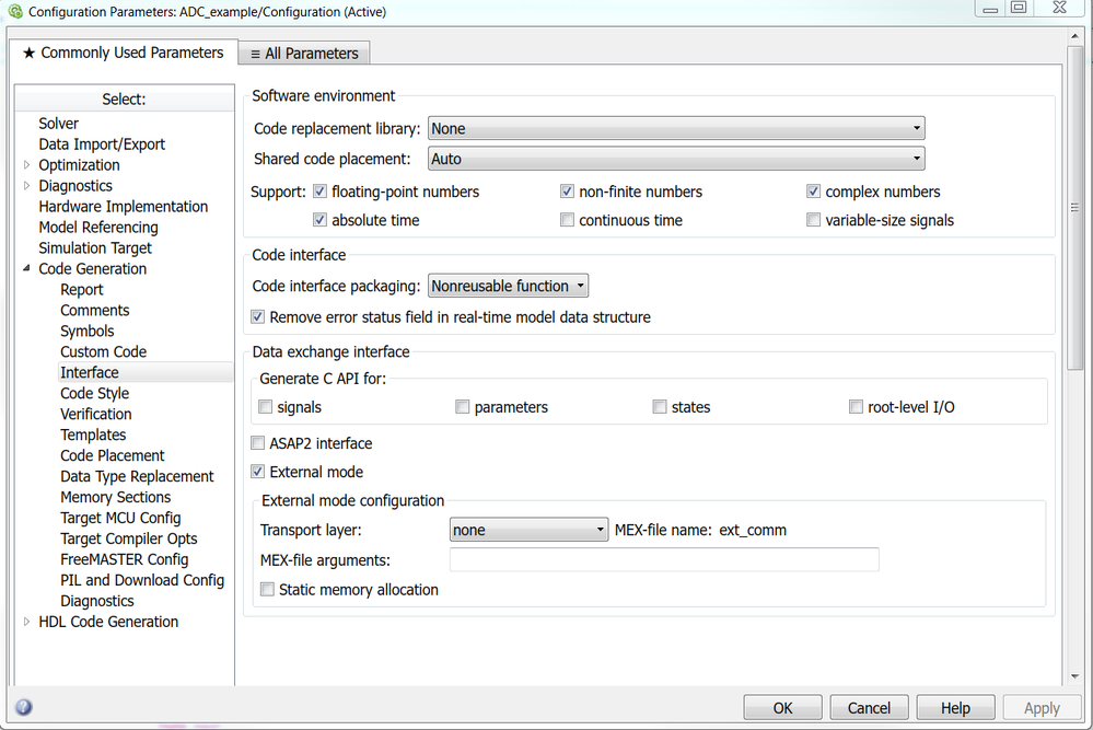

Hello everyone,
I have question regarding Simulink External Mode for development board with MPC5744P. Is it possible to run External Mode on that? All what I was able to find, it's examples with SIL, PIL and also External Mode for  S32K148EVB, but nothing about that for EVKIT-MPC5744P. From example for  S32K148EVB, I've assumed that is necessary to chose transport layer and MEX-file arguments into External mode configuration block (see picture below), but in my case there is none. I'm not strong familiar with this type of setting and if somebody will be able to point me or provide some example, it would be great.
I'm using Mathlab 2016b and below a screenshot with Code Generation/Interface settings.

Unfortunately for MBDT MPC5744P v2.0.0 we don't have support for external mode - this feature was introduced in our latest release for S32K14x. We are currently working on a MPC574xP/B/C/G toolbox, which we will release mid-February 2019. In this release we will have support for both SIL and PIL, but probably not for external mode.

I can not speak for other companies, but on our side there is no hardware issue, just that we always make decisions regarding what gets done for a release  and what doesn't - and for MPC57xx family toolbox, external mode did not make the cut - not yet at least. It is on our radar, but for the moment we do not have a plan for our next update on this product. I will get back to you on this subject when I'll have more information to share.

I have added this request in our backlog. Judging by the high interest shown for this feature it is likely to be part of our next release of the MPC57xx toolbox.
