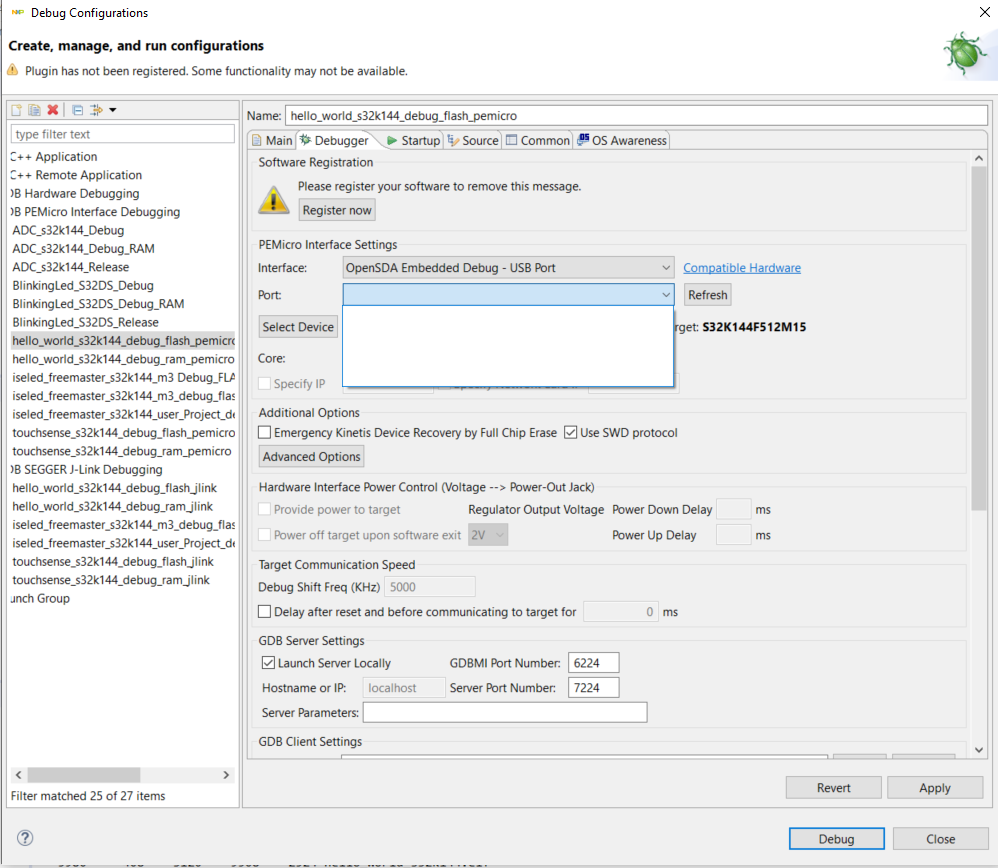

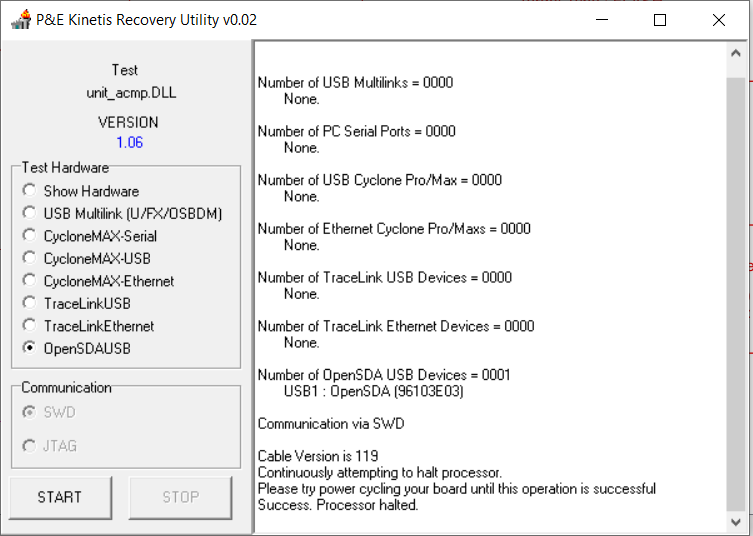

mariuslucianand
Hello [email protected]‌,
Impressive work!
The reason for which the OpenSDA is not displayed in step 6 is that you did not close the Recovery Utility after the processor was halted as I have mentioned in my latest reply.
2. Open the program, select the OpenSDAUSB, and press start. If you get the "Success. Processor halted" message, then you are the right path, close the Recovery Utility and go to the next step.
Anyway, you are on the right path :smileygrin:. Closing the Recovering Utility will keep the processor in halt, so you can flash the new code using the S32DS.
Now, at step 13, I would try with another model, the gpio example from our toolbox, and then you can try your model too. Try with the gpio just to be sure that the board will not act the same, entering reset.
You can also send me your ADC model to try it on one of my boards. The model and the generated .mot file.
Hope this helps,
Marius

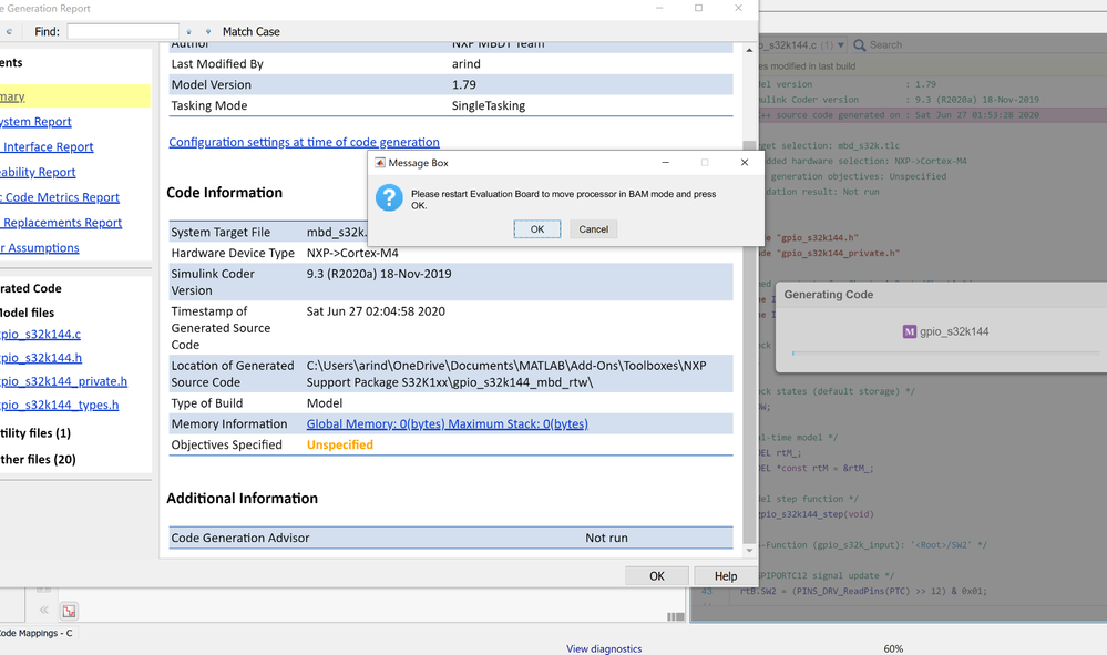

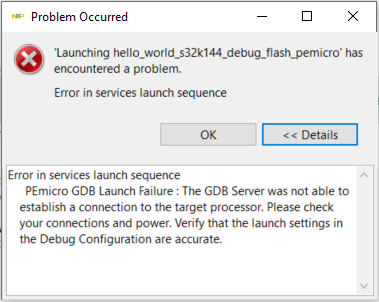

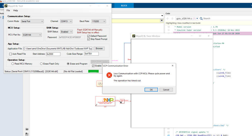

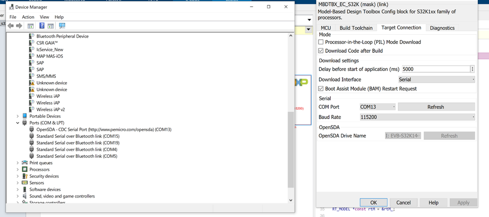

abiswas
Hello mariuslucianandrei‌,
First I want to appreciate your effort to help me out in this project.
Here are the updates. Manually coding with S32DS works.
Second, I downloaded the bootloader GUI, I uploaded the bootloader to the MCU as well as with S32DS.
Afterward, Once I attempted programming It (The gpio .mot file generated by Simulink) showed me this message.
Next, I unplugged and plugged again the board. This time once powered I observed the red light of death again ( just trying to find some fun out of this unfortunate situation :smileygrin:).
Earlier, the S32DS took the red light off, and now it's on again.
Now it just asks me to cycle through power again and again.
So I thought okay maybe the problem with the GUI lets try Simulink.
I flashed the board using S32DS again to take the red led off.
Then I configured Simulink.
Now I hit build-
and here we go again-
So I clicked reset.
Now we have the red light of death again.
It is now asking to cycle through power again and again. The only way to revive the board is to program it with S32DS.
I was really excited about this since I have experience with eclipse based coding (code composer studio from TI) but not model-based which makes things a lot easier. However, the resources are very scarce as I tried to find a solution to this. I would really love to have this board work as it was shown in the tutorial series.
Looking for a solution soon.
Thanks for helping again.

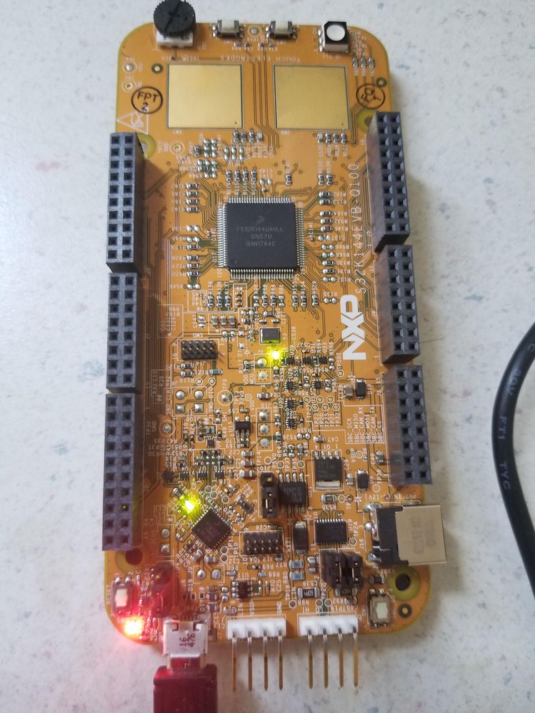

Because the code report in the .txt file looks good, can you please send us the led status on the S32K144 EVB board?
I am interested in the D1 LED ( the one next to the RESET button)
D2 LED (next to the Open SDA - if it blinking or always on)
D3 LED (next to the oscillator, in the middle of the board).
Also please be sure the two jumpers are in the right position as in the QSG
https://www.nxp.com/docs/en/quick-reference-guide/S32K144EVB-QSG.pdf

abiswas
Hello mariuslucianandrei,
Thank you for your reply.
Here are the led status-
1. D1 (It's always on but flickers during code upload from Simulink)
2. D2 is always on but flickers during code upload.
3. D3 is always on.
Jumpers-
Both the jumper J104 and J107 is in 2-3 position
For your convenience, here is a video of the operation.

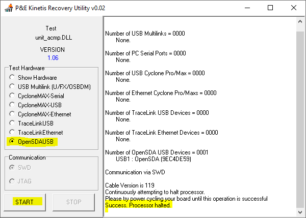

mariuslucianand
Thank you for this detailed explanation of the issue!
The problem you are facing is not related to the generated code. The issue is related to the board.
The D1 LED is continuously turned on, which means that the MCU is in the reset state all the time. In other words, it is bricked and cannot be recovered from the reset state by the usual flashing procedure. So in order to bring the processor back to like a program called Kinetis_recovery has to be downloaded from PEMicro's website. Please get this application that will help you to recover the MCU.
More details can also be found on this website with a large description of the issue: Bricking and Recovering FRDM-KL25Z Boards: Reset, SWD Clock and Low Power | MCU on Eclipse .
This happens some times, so I will try to guide you through the steps I am usually performing, especially that the link above is for the Kinetis platform, not S32K, but both platforms are similar.
1. Download the Kinetis_recovery.
2. Open the program, select the OpenSDAUSB, and press start. If you get the "Success. Processor halted" message, then you are the right path, close the Recovery Utility and go to the next step. Otherwise, you should start power cycling the board until the message appears. If you can't halt the processor than an external probe might be required, but let's hope it will work with the OpenSDA.
3. Now, I usually flash the program with the S32 Design Studio IDE for Arm® based MCUs | NXP. So, Open S32 Design Studio for ARM, File -> New -> S32DS Project from Example, Import the hello_world_s32k144.

abiswas
Thank you for your help. Here are the steps that I tried-
1. Halted the processor.
2. Opened S32 Design Studio for ARM.

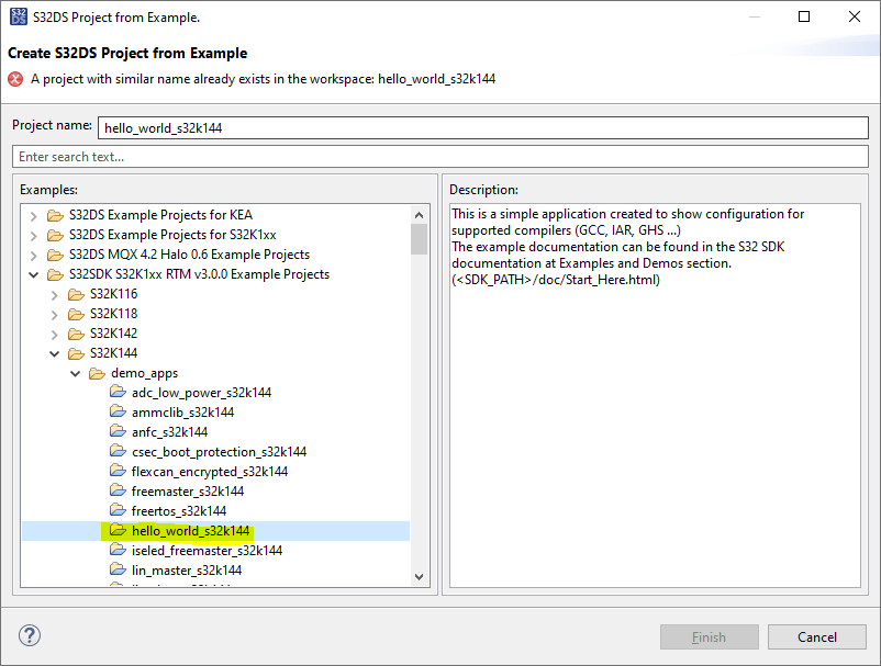

3. Imported the hello world code for S32K144.
4. Clicked debug configuration.
5. It showed failed to connect.
6. Then I went to the debug configuration menu to select the debugger. It couldn't find the debugger.
7. I unplugged and plugged again the board. It still didn't find the debugger. Out of frustration, I tried uploading the Simulink code again. It uploaded.
8. Now in S32 Design suite debug configuration it found the debugger.
9. I uploaded the code and run the debug.
10. Now I can see the flashing LED.
11. I terminated the debug session however it didn't return to its normal operation (flashing the led) instead it was stopped at one led blinking (probably halted, no reset on termination happening).
12. I clicked the reset pin. It started flashing again. (Phewww).
13. Then I went to Simulink and uploaded the code.
14. But it's still the same. The red led beside the reset button still blinking with no other changes if I change the potentiometer.
15. I tried to click the reset pin.. nothing changed.
My assumption- when the Simulink uploads the program the upload sequence doesn't provide a reset or start command. At this point, the reset pin is also disabled somehow.
What should I do next? I really appreciate your effort.
