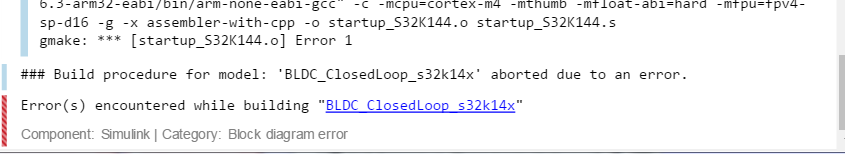

For the seconde issue please find blow the hole log:
Build 4 2 1 Clear
11:12 AM Elapsed: 29 sec
### Starting build procedure for model: BLDC_ClosedLoop_s32k14x
### Generating code and artifacts to 'Model specific' folder structure
Code Generation 2 2
Elapsed: 27 sec
### Generating code into build folder: D:\Project\_Standard_Library_ALGO\Prototypage\BLDC_ClosedLoop_s32k14x_mbd_rtw
Self-transition #357 could be removed. 'B' has no children, and it does not cause any action or side-effect. [2 similar]
Component:Stateflow | Category:Coder warning
### Invoking Target Language Compiler on BLDC_ClosedLoop_s32k14x.rtw
### Using System Target File: D:\Users\Bender1M\Documents\MATLAB\Add-Ons\Toolboxes\NXP_MBDToolbox_S32K1xx\code\mbdtbx_s32k14x\mbdtbx_s32k14x\mbd_s32k14.tlc
### Using Model-Based Design Toolbox for S32K1xx Series 2018.R1 (R2016b-R2018a) 23-Jul-2018
### Loading TLC function libraries
### Generating TLC interface API for custom data
### Initial pass through model to cache user defined code
### Caching model source code
### Writing header file BLDC_ClosedLoop_s32k14x_types.h
### Writing source file BLDC_ClosedLoop_s32k14x.c
### Writing header file BLDC_ClosedLoop_s32k14x_private.h
### Writing header file BLDC_ClosedLoop_s32k14x.h
### Writing source file Hall_Emulation_Sequence.c
### Writing source file Motor_Speed_Request.c
### Writing source file FIRparams.c
### Writing header file freemaster_cfg.h
### Writing header file freemaster_interface_init.h
### Writing source file freemaster_interface_init.c
### Writing header file rtwtypes.h
### Writing header file Hall_Emulation_Sequence.h
### Writing source file BLDC_ClosedLoop_s_Calculate_RPM.c
### Writing header file BLDC_ClosedLoop_s_Calculate_RPM.h
### Writing header file Motor_Speed_Request.h
### Writing source file mbd_main.c
### TLC code generation complete.
### Processing Template Makefile: D:\Users\Bender1M\Documents\MATLAB\Add-Ons\Toolboxes\NXP_MBDToolbox_S32K1xx\code\mbdtbx_s32k14x\mbdtbx_s32k14x\mbd_s32k14.tmf
### Creating BLDC_ClosedLoop_s32k14x.mk from D:\Users\Bender1M\Documents\MATLAB\Add-Ons\Toolboxes\NXP_MBDToolbox_S32K1xx\code\mbdtbx_s32k14x\mbdtbx_s32k14x\mbd_s32k14.tmf
### Building BLDC_ClosedLoop_s32k14x: .\BLDC_ClosedLoop_s32k14x.bat
D:\Project\_Standard_Library_ALGO\Prototypage\BLDC_ClosedLoop_s32k14x_mbd_rtw>set MATLAB=C:\Program Files\MATLAB\R2017b
D:\Project\_Standard_Library_ALGO\Prototypage\BLDC_ClosedLoop_s32k14x_mbd_rtw>"C:\Program Files\MATLAB\R2017b\bin\win64\gmake" -f BLDC_ClosedLoop_s32k14x.mk COPY_MDLREF_INCLUDES=0 ISPROTECTINGMODEL=NOTPROTECTING GENERATE_ERT_S_FUNCTION=0 INCLUDE_MDL_TERMINATE_FCN=1 COMBINE_OUTPUT_UPDATE_FCNS=1 MULTI_INSTANCE_CODE=0 INTEGER_CODE=0
Cleaning...
RELATIVE_PATH_TO_ANCHOR is ..
==== Removing object files from build directory ====
Copying necessary files to build directory...
Compiler details : "D:\Users\Bender1M\Documents\MATLAB\Add-Ons\Toolboxes\NXP_MBDToolbox_S32K1xx\code\tools\gcc-6.3-arm32-eabi/bin/arm-none-eabi-gcc" -c -c -mcpu=cortex-m4 -mthumb -mfloat-abi=hard -mfpu=fpv4-sp-d16 -O1 -g -gstrict-dwarf -DARM_MATH_CM4 -D__FPU_PRESENT=1 -D__FPU_USED=1 -D__NVIC_PRIO_BITS=FEATURE_NVIC_PRIO_BITS -o SetupFiles -DCPU_S32K144HFT0VLLT -I. -I.. -I.. -I"C:\Program Files\MATLAB\R2017b\simulink\include" -I"C:\Program Files\MATLAB\R2017b\extern\include" -I"C:\Program Files\MATLAB\R2017b\rtw\c\src" -I"C:\Program Files\MATLAB\R2017b\rtw\c\libsrc" -I"C:\Program Files\MATLAB\R2017b\rtw\c\src\ext_mode\common" -I"C:\Program Files\MATLAB\R2017b\rtw\c\src\ext_mode\tcpip" -I"C:\Program Files\MATLAB\R2017b\rtw\c\src\ext_mode\serial" -I"C:\Program Files\MATLAB\R2017b\rtw\c\src\ext_mode\custom" -ID:\Project\_Standard_Library_ALGO\Prototypage -IC:\PROGRA~1\MATLAB\R2017b\simulink\include\sf_runtime -ID:\Project\_Standard_Library_ALGO\Prototypage\BLDC_ClosedLoop_s32k14x_mbd_rtw -I"D:\Users\Bender1M\Documents\MATLAB\Add-Ons\Toolboxes\NXP_MBDToolbox_S32K1xx\code\tools\gcc-6.3-arm32-eabi/arm-none-eabi/include" -I"./common" -I"./inc" -I"./src/clock/S32K1xx" -I"./src/sim/S32K144" -I"./src/power/S32K1xx" -I"./S32K144/include" -I"../common" -I"../inc" -I"../src/clock/S32K1xx" -I"../src/sim/S32K144" -I"../src/power/S32K1xx" -I"../S32K144/include"
Assembler details : "D:\Users\Bender1M\Documents\MATLAB\Add-Ons\Toolboxes\NXP_MBDToolbox_S32K1xx\code\tools\gcc-6.3-arm32-eabi/bin/arm-none-eabi-gcc" -c -mcpu=cortex-m4 -mthumb -mfloat-abi=hard -mfpu=fpv4-sp-d16 -g -x assembler-with-cpp -o SetupFiles
Product: BLDC_ClosedLoop_s32k14x.mot
Build product type: executable
Building file startup_S32K144.o...
"D:\Users\Bender1M\Documents\MATLAB\Add-Ons\Toolboxes\NXP_MBDToolbox_S32K1xx\code\tools\gcc-6.3-arm32-eabi/bin/arm-none-eabi-gcc" -c -mcpu=cortex-m4 -mthumb -mfloat-abi=hard -mfpu=fpv4-sp-d16 -g -x assembler-with-cpp -o startup_S32K144.o startup_S32K144.s
### Build procedure for model: 'BLDC_ClosedLoop_s32k14x' aborted due to an error.
Error(s) encountered while building "BLDC_ClosedLoop_s32k14x"
5,236 次查看

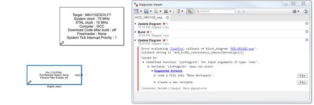

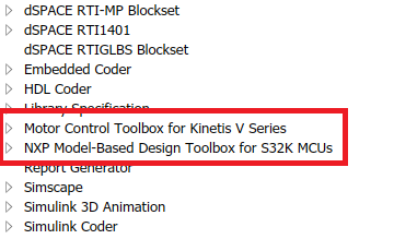

m_benderradji
Hi Marius,
I have installed CodeWarrior IDE and i have set-up the compiler as it is described in your previous response.
Now i am trying to build a basic model using the "Motor Control toolbox for MKV10Z Family". I have the following error:
Could you please tell me what i need to do to resolve this issue. For your information i have also the NXP MBDT 2018.R1 for S32K MCU's installed. Are there a conflict between the two toolbox ?
Thanks in advance for your support.
Best regard
5,236 次查看
mariuslucianand
Hello m.benderradji@outlook.fr‌,
You are facing a known issue related with the Matlab's API.
Please apply the Hotfix 9 from this link https://community.nxp.com/message/1008960?commentID=1008960#comment-1008960
Hope this helps you!
Marius
