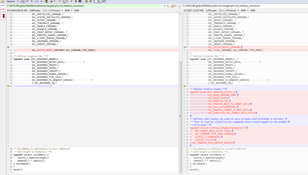

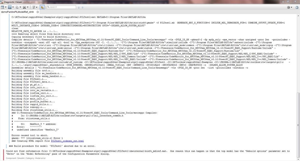

damarandei
I am running into a very similar issue as well with Matlab/Simulink 2018a, version 2 of the MBD Toolbox.
I added C:\MATLAB\global\R2018a\toolbox\rtw\targets\pil\c to Custom Code tab in Code Generation to get past not finding xil_interface_lib.h but I get
"C:\MATLAB\global\R2018a\toolbox\rtw\targets\pil\c\xil_interface_lib.h", line 27: error #20: identifier "MemUnit_T" is undefined uint32_T serverFcnId, MemUnit_T xilResponseId,
It looks like MemUnit_T didn't change with the updates so I am not sure how to fix it:

dynexdave
Hi paulvlase, dumitru-daniel.popa,
I think I've made some progress by adding the file location (enclosed in " ") into the build include search path in Matlab (Simulation -> Model Configuration Parameters -> code generation -> custom code -> Additional build information -> include directories...).
I'm now seeing the following error:
I've looked in xil_interface_common.h and I can see the use of MemUnit_T but it isn't defined. I've traced back through the header files but can't find a definition. It seems as though there is an issue in setting paths as this must be defined somewhere. Not sure whether this is down to Matlab version? I'm on 2016a. Do you know if this type is defined in one of your header files? Any ideas?
David

dynexdave
Update: I've found the header file location, I see that it is a Matlab file. Why would it have an issue finding this? the folder where the file is located should be in the search path. How can I tell the build process to include this file location as an include directory?

dynexdave
Hi dumitru-daniel.popa,
Thanks, I managed to solve the last issue by re-installing CodeWarrior in a directory without spaces :smileyhappy:

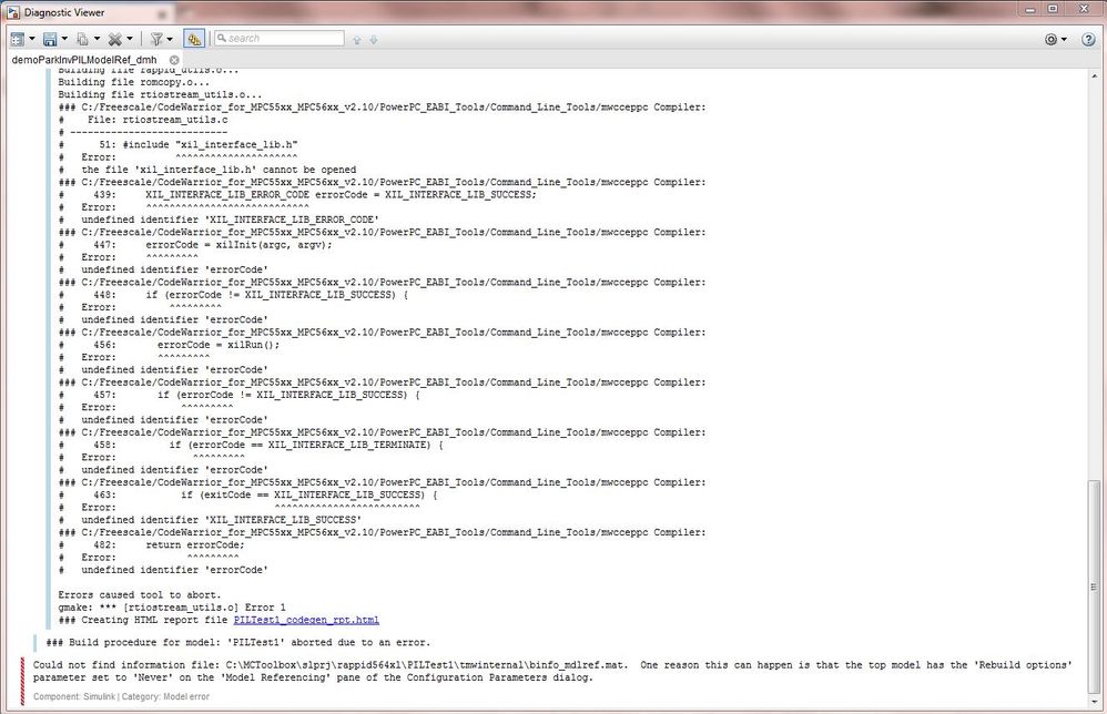

I've now run into a new issue... There is a header file that it cant seem to open, see diagnostics below
I believe this header file is required for the serial communication. Not sure where the file should be or why it is unable to pull it though. I'm guessing somewhere you must be able to tell the build process (from Matlab) what additional include directories should be used? Is this header file something NXP supply?
Getting there slowly :smileyhappy:

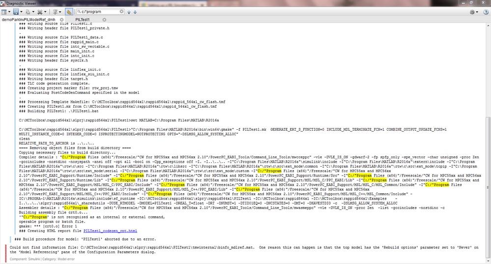

dynexdave
I've reverted to Matlab 2016a to try and test this. I can now click on the blue box and that runs the script that sets default values.
I've also installed the virtual COM port driver and that is working.
However, when I try and run the demoParkInvSILModelRef PIL simulation (with target attached to PC) I get the following error:
I'm not really sure what the problem is... doesnt seem to like 'C:/"Program ' but I can't see why. If you have any ideas can you please let me know?
By the way, my environment variable is set to:
MW_TOOL = C:/"Program Files (x86)"/Freescale/"CW for MPC55xx and MPC56xx 2.10"
David

Daniel_Popa
Hi David,
Your issue is similar with this one: https://community.nxp.com/message/922658?commentID=922658#comment-922658
Most likely is due to 8dot3 mode.
You could try that solution - hope it will work in your case too.

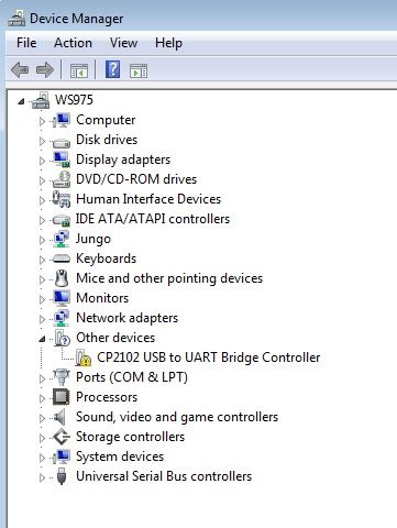

After successfully running the demoParkInvSILModelRef demo and resolving a hardware issue with our target I'm ready to try the demoParkInvPILModelRef PIL demo simulation :smileyhappy: I tried it but ran into problems.
  • The target I'm using is the evaluation board supplied with the dual motor kit Dual 3-phase PMSM Kit with MPC5643L MCU|NXP It is currently disconnected from the rest of the evaluation kit so I only have the control board.
  • I have a USB cable connected directly between the PC and the USB port on the evaluation board. This is what I see in the device manager:
The device is listed under 'Other devices', the COM ports don't change at all. I was expecting to see a COM port occupied as that's what I need to enter into the RAppID Target Setup Box. Am I doing something wrong here?

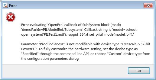

  • In the demoParkInvPILModelRef model, if I click on the blue box as instructed I get the following error:
I believe clicking this box just sets some configuration parameters. I've checked and as far as I could tell all these parameters are correctly set anyway but I thought I'd mention it.

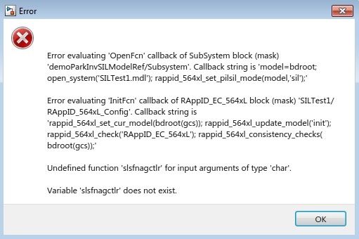

Sorry, I have been pretty busy this last few days! I went back to the RAppID examples today. There are two that I think are particularly useful: demoParkInvSILModelRef and demoParkInvPILModelRef, these contain SITTest1 and PILTest1 respectively. I started with the SIL model demo (which I think should be independant of hardware), when I click on the blue box on the model root/home page I get the following error message:
I assume clicking on the blue box is supposed to make apply some configuration/setup?
Similarly if I just try to run the model I get an error in the Matlab Diagnostic viewer saying:
Error evaluating 'InitFcn' callback of RAppID_EC_564xL block (mask) 'SILTest1/RAppID_564xL_Config'.
Callback string is 'rappid_564xl_set_cur_model(bdroot(gcs));
rappid_564xl_update_model('init');
rappid_564xl_check('RAppID_EC_564xL');
rappid_564xl_consistency_checks( bdroot(gcs));'
Caused by:
Undefined function 'slsfnagctlr' for input arguments of type 'char'.
Variable 'slsfnagctlr' does not exist.
I have no idea what this variable is for or what it should be set to. I'm thinking that if I first get the SIL demo working then I can move onto the PIL demo (which incidentally has the same problem).

Daniel_Popa
Hi David,
Please have a look here: https://community.nxp.com/thread/467975
Thank you!

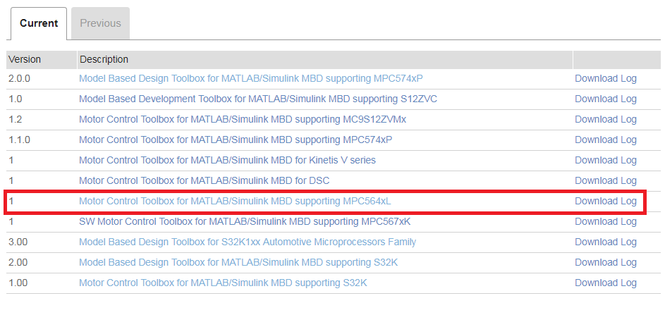

Daniel_Popa
Hi dynexdave‌
Yes, that is the correct link to the Toolbox main page.
You need to click on "Download Eval" Button and then you will reach to a page like this:
Select the link highlighted, and you will see this.
Download and install it and have fun!!!
PS: direct link to the MPC564xL Toolbox is: https://nxp.flexnetoperations.com/control/frse/download?agree=Accept&element=6107501

dynexdave
Hi dumitrupopa,
Thanks for the links, I've managed to get it installed OK. Now I'm trying to now figure out how to connect everything up to the PC to try it :smileyhappy: Are there any guides/documentation to go with the toolbox?
