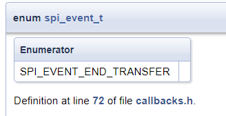

I've recently been stuck with SPI Interrupt by the receiving data from slave. The problem is what I want to trigger subsystem by the interrupt from received data. But in the NXP MBD Toolbox for MPC57xx v.3.0.0, I cannot find this type of interrupt in the SPI_ISR block, only END_OF_TRANSFER_ISR is available. At the same type, there is DSPI_Receive_Trigger in old version 2.0.0 of MBD, as well as DSPI_ISR block with 5 possible sources of interrupt and even examples with mentioned above interrupt.
What's reason to remove DSPI_Receive_Trigger in v.3.0.0 and how this functionality can be performed in the current case? Any suggestions are appreciated.

The shortest answer I can give - in 2.0.0 we wrote the drivers ourselves, while in 3.0.0 we used the NXP SDK drivers. Unfortunately even in the latest version of the SDK we only have SPI_EVENT_END_TRANSFER event available.
