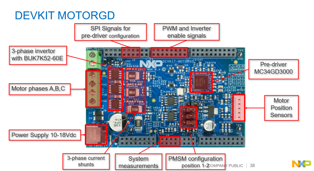

Does this development kit comes with motor fitted with encoder or resolver or does it have only encoder interface?
1,630 Views
Daniel_Popa
Hi Aniket,
The kit comes with a 3-phase motor that is equipped with 3 hall sensors (no encoder, no resolver)
On the MotorGD DevKit, there is connector JP1 (Motor Position Sensors) that can be used in conjunction with motor fitted with:
- incremental encoders
- digital hall sensors
Hope this helps!
