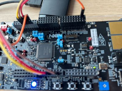

Just to be sure, have you made the same connections as in the table below:
I have made same connections on my board, for example connecting pin PTB3 with PTB15, PTB2 with PTB16 on so on, according to the table above:
 The blue LED will start blinking once per second.

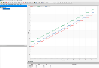

Open the s32k3xx_spi_async_interr_s32ct.pmpx with FreeMASTER and see the values increasing:
  • master_send
  • master_recv
  • slave_recv

As for Your guide, I tried switching to S32K344-Q172 S32 Config Tool from Simulink Hardware Settings and build the project. This resulted in the same issue of no data exchange between MOSI and MISO pins.  What comes to FreeMaster preview, only the master_send variable was displaying a change in value.

Also please connect the 4 wires as in the diagram below:
The above connections are the same in the table provided in the help s32k3xx_spi_async_interr_s32ct_example_readme.html:
Please follow the steps above and this will result in a working setup for the SPI model.
