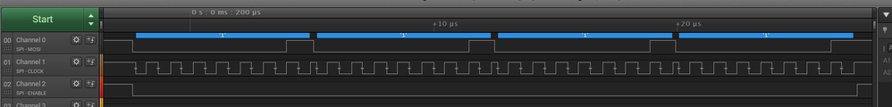

I got a 16 bit frame data as seen in below snap shot (the clock is 16 bit, as the input data was 1 (seen in pink)). It takes 16 clock to transmit the data where it shall take only 8.
2. Attempt 2
I used 8 bit frame size
Result
A bit better but data seems to be corrupted (as the input is [1 1 1 1], I expect the green box behavior and not the orange box, as shown below)
Please let me know how to deal with this problem.

So for the first try - you can not have frame size set to more than 16 bits; only from 4 to 16 are supported by the hardware. As for your 2nd configuration, that was ok - 8 bit frame size, continuous transfer enabled. If you pair this with a [1 1 1 1] vector (uint8 type, so that we get 32 bits in total), everything should be fine.
So from what you can see here, having in mind that settings for clock are:
- clock polarity: active low
- clock phase: 1st edge
We can see that the first '1' is centered on the 8th negative edge of the clock, and it does not stretch on the 9th one. This is repeated over all 4 bytes.

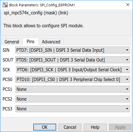

I must specify that I've used instance 3 (SPI3) for convenience, with the following pins.
Could you confirm that with this configuration, everything works?

Dear constantinrazvan.chivu‌
It works well (I tested with SPI2 and SPI3)
Just to add: We should use continuous transfer, for more than 16 bit transfer as mentioned in the Reference Manual.

Glad to hear that! And you are correct, continuous transfer should be used for more than 16 bit transfers, with the mention that the you must make sure the transfer size (total bits transmitted) is a multiple of the frame size (for example you can't send 24 bits (transfer size) with 16 bit frame size).
