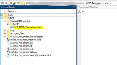

Everywhere it is specified that the two examples of engine control are in FreeMaster. I can't find any pmp files for them. I know from the example for S32K144 that I download an run an install MTRDEVKSPNK144_SW.exe  that creates a folder where you could find pmp and the project for S32DS. For S3xx does not exist such a program.
 You can find the FreeMaster project, inside the FreeMASTER_control folder of each PMSM/BLDC example, located inside the mc folder of the S32K3_Examples.
