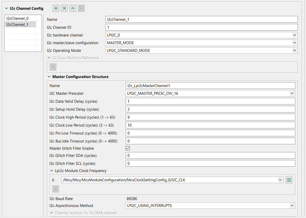

A few observations about the S32CT configuration, I saw that you have configured I2cChannel_1 (LPI2C_0) as Master and used it in your model. Since this channel was previously configured as Slave in the default configuration project, switching it to master mode enables some additional settings that need to be configured for the channel to work as expected. As you can see in the image below, you need to add a clock source for the Lpi2c Module Clock Frequency.
You can configure the I2C_CLK in the Mcu Clock Reference Point tab and set it to the AIPS_SLOW_CLK source. The I2C Master Prescaler, I2c Clock High Period and I2c Clock Low Period parameters also need to be modified to get the right I2c Baud Rate.
