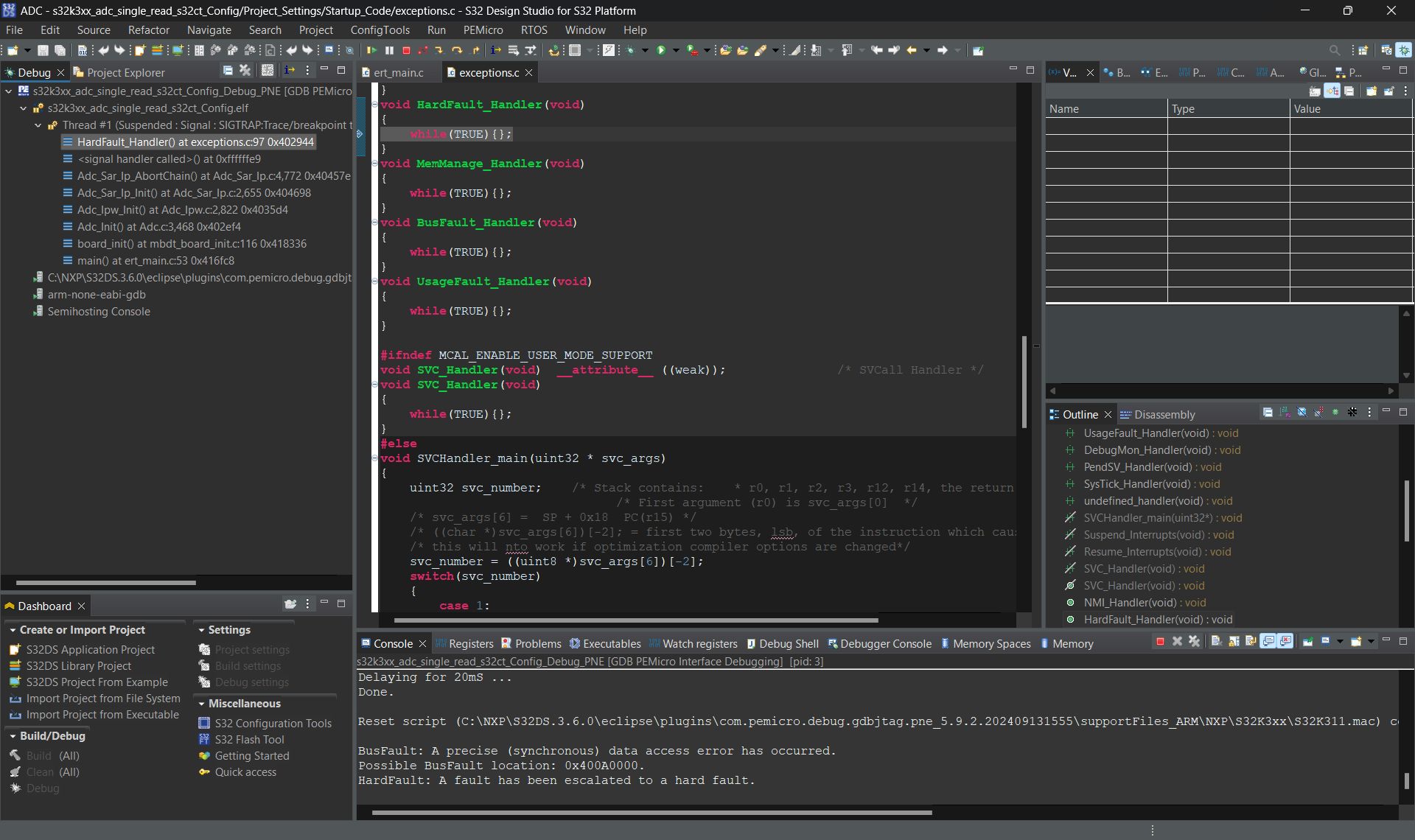

I have been able to configure the ADC1 in the S32 configuration tool and have successfully added 2 sampling groups.
However, when I try to do the same for ADC0, I end up getting a Hardware Fault interrupt.
I have tried configuring both with and without ADC1 also configured, with the same results.
Is this a known issue with the MBDT?

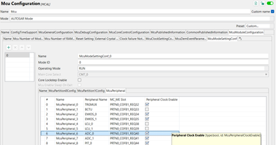

Thanks, I had missed this step:
Then we need to enable the ADC0 peripheral clock in MCU Configuration -> McuModuleConfiguration -> McuModeSettingConfig:

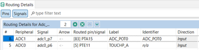

In your case with the the S32K31XEVB-Q100 EVB board, there is only one ADC1 channel configured in the S32CT.

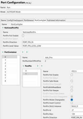

If you want to add an ADC0 channel, we need to first add a pin intro Pin Manager:
For example PTE11 pin is on ADC0 and connected to TOUCHO_A on the board.
Next we need to add thisPTE11 pin in Peripherals -> Port Configuration:

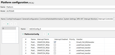

Then we need to enable the ADC0 interrupt in Platform Configuration -> Interrupt Controller:
Scroll down the Interrupt Controller page and find and enable ADC0:

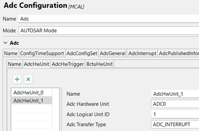

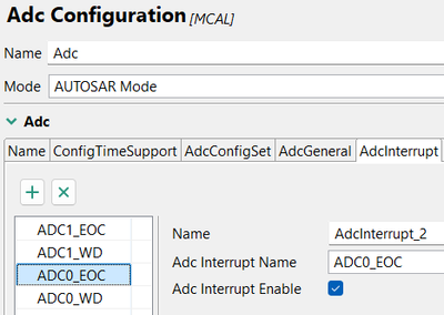

We need to add ADC0_EOC and ADC0_WD in ADC Configuration-> ADC Interrupt:
Then we need to add another ADC Hardware Instance in ADC configuration:

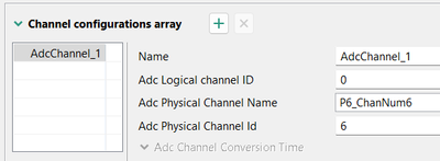

After we need to configure the Channel configurations array P6_ChanNum6:

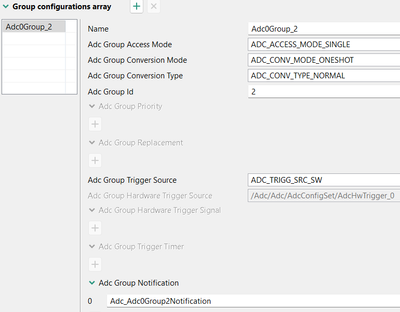

Update the Adc0Group_2 with the Adc_Adc0Group2Notification in the Group configuration array:

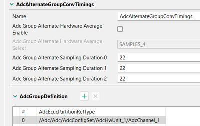

Select the AdcChannel_1 in the AdcGroupDefinition:

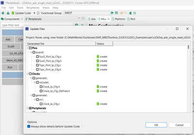

After this we can Update Code and a pop-up Update Files will appear, press OK:
After this process is done, we can close S32CT and go back to the model.

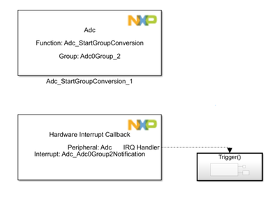

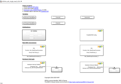

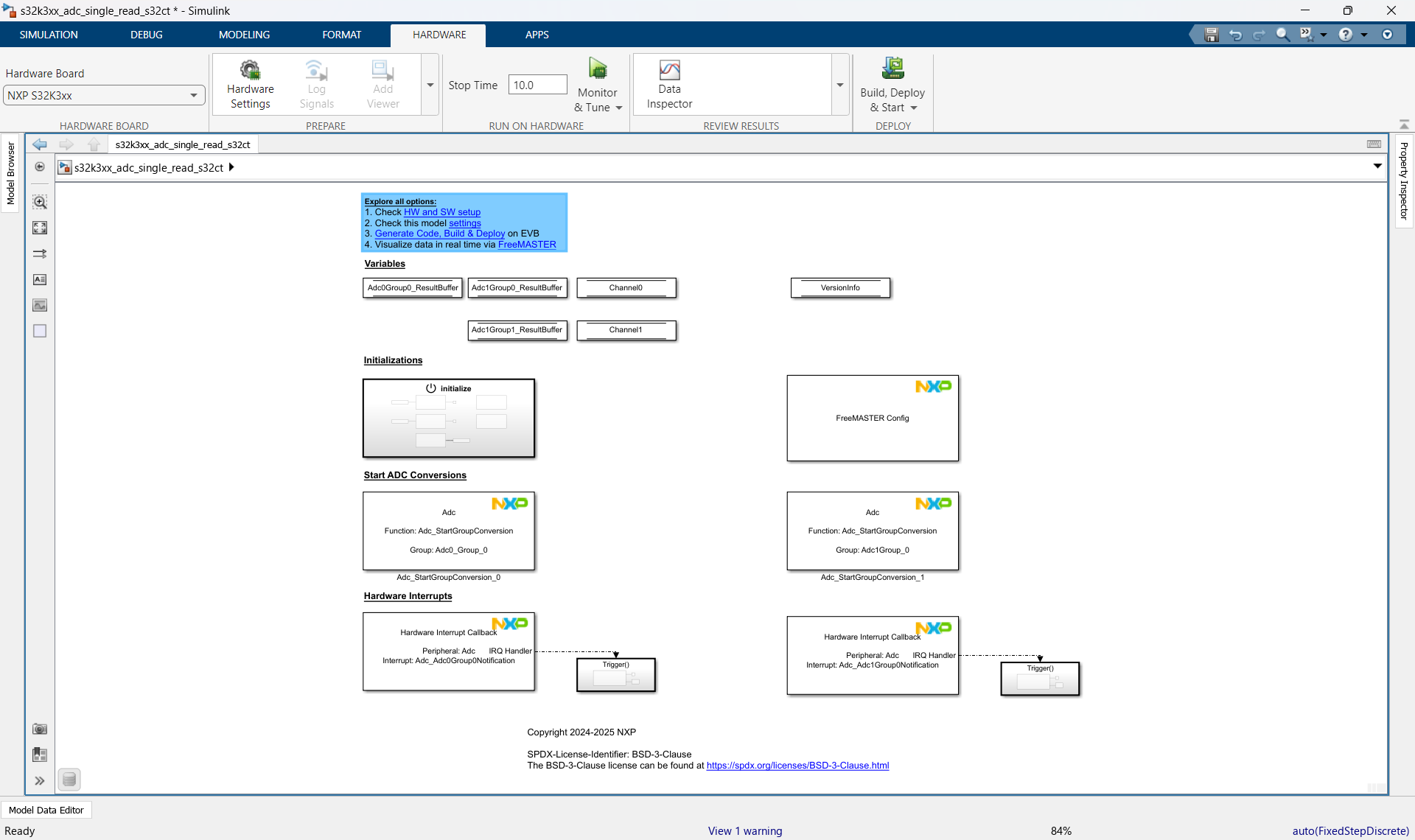

Update in the s32k3xx_adc_single_read_s32ct model, with Adc0Group_2:
Then go back to MATLAB and delete the following:
  • s32k3xx_adc_single_read_s32ct_ert_rtw
  • slprj
  • s32k3xx_adc_single_read_s32ct.slxc
Select Yes to all, then go back to the s32k3xx_adc_single_read_s32ct.mdl and press on Build, Deploy &Start (keyboard shortcut CTRL+B

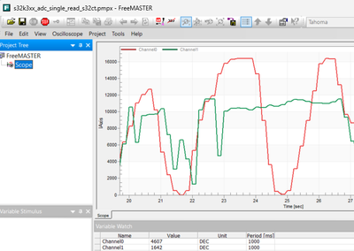

After the generated code is automatically flashed into the S32K311EVB, open FreeMaster and watch the newly added Channel_1:
