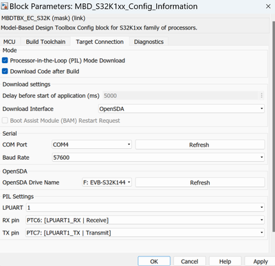

1) in the configuration block the card is recognized without problems

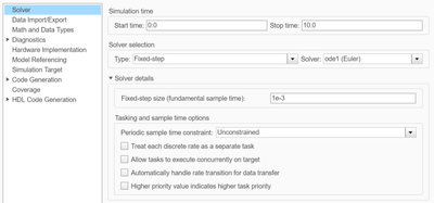

2) in the solver configuration I used fixed step and a numerical integration time which for this type of control scheme should not cause problems when it comes to computational complexity.

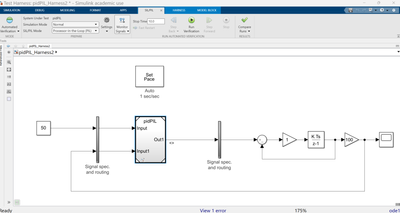

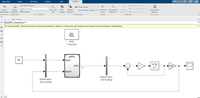

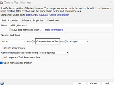

3) via Simulink Test APP, the model for test harness is created, without any errors, and the control loop with the discretized first order system is set "outside". I point out that the dynamics of the system are quite "relaxed" so I doubt it is something related to computational complexity.
 (l'ho chiamato pidPIL_Harness2 invece che 1 per mia convenienza, non è un errore...)
4) with SIL/PIL APP I set processor-in-the-loop in the settings, and the preliminary simulations are completed without errors (because in fact the model contains no errors...)

First of all, the settings from your screenshot of the MBDT_S32K1xx_Config_Information look good. I hope that the same block and settings are also placed in the referenced model.
Placing the configuration code in the model is the way of setting the hardware target for the referenced model as well. I know that only the application is supposed to be there but this is how the MBDT for S32K1 works.
What I have noticed from your model is that the pidPIL, does not have black corners, and there is no PIL written between parenthesis and as you say, the Test Harness sets the model to be executed in PIL mode. This is why I would try first that the System under test is Model blocks in SIL/PIL mode and select the system which is to be executed in PIL mode, just like in the screenshot attached below:

Thinking on what you sayd about bolded black corners, as a proof of that is not related on how you define the test harness at the first step, now i explicit the PIL mode, and the block have the form you think is correct.
Exactly the same error appear again (again!!.).

In the figure I see, you have not gone through the creation of the Harness test via Simulink Test App. But you use SIL/PIL directly, and this is in fact the reason why you have to make explicit the "Model blocks in SIL/PIL mode" item from the user interface of Simulink as "System Under Test".
As regards the "marked black corners and the writing (PIL)", this is because you have simply recalled the model you are interested in via a "Model" block (from Ports & Subsystem), you have selected the processor in the loop item as "Simulation fashions".
When you use the test harness it is automatically defined which part of the slx model will be processed on the MCU, in fact in the photo I sent you "System Under Test = pidPIL" which is precisely the model from which the Harness is generated.
In this way everything that is "external" is processed on the host PC instead. The black corners and the writing PIL would appear if the procedure was able to generate .elf and .mot files, which is no longer possible given the error on the "PIL conncetivity" which cannot be resolved.
