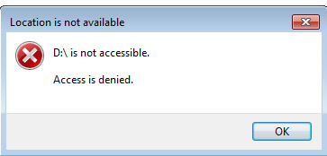

1) I try to build push button controlled LED model using Simulink. code has been generated but there is an error which is shown below. it is showing access denied error.
### Created executable: gpio.mot
Generating S-record...
"C:\Users\puneae1\AppData\Roaming\MathWorks\MATLAB Add-Ons\Toolboxes\NXP_MBDToolbox_S32K1xx(3)\tools\gcc-6.3-arm32-eabi/bin/arm-none-eabi-objcopy" -O srec gpio.elf gpio.mot
Created S-record: gpio.mot
Building target all
*** Created executable: gpio.mot
### Successful completion of build procedure for model: gpio
COPY CATCH: Access is denied.
: >> C:\Users\puneae1\AppData\Roaming\MathWorks\MATLAB Add-Ons\Toolboxes\NXP_MBDToolbox_S32K1xx(3)\gpio_mbd_rtw\gpio.mot
Can't download the file to the board.
2) I also tried to accesing D drive(s32k-EVB(D)) but it shows access denied.

mariuslucianand
Hello [email protected]‌,
Do you have enough user permissions in order to access the mounted disk? I think there is a problem related with your local user rights, so you should contact your IT administrator.
Until then, you can try flashing the board using the S32DS. You go to Flash from file, select the generated elf/mot and flash it on the board. Under Debugger tab you should see a recognised OpenSDA. This might work.
Hope this helps,
Marius

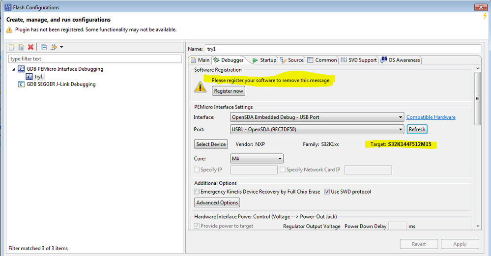

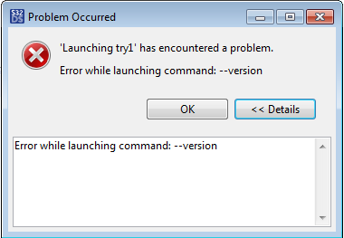

                   I try to flash generated try1.mot file from flash from file option in S32DS. I have encountered this error.
under debugger option I have done following setting
4,670 Views
mariuslucianand
The register message is not an issue right now. So I assume you have created an empty project for S32K144. The settings from this tab seems to be right and it seems to have access to the OpenSDA.
From the error message you have, it looks like it is not able to access access gdb.
To see if all the project settings are performed right, please import a project from SDK and try debugging that. Please go in S32DS to File -> New ->  Create S32DS Project from Example and try flash that.
If this works, on the same project you can change the elf with the one generated from Matlab.
Hope this helps,
Marius

aniket_bagade
Hi Marius
its working!
Thank you.
