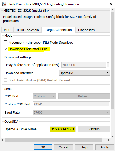

1)when I connect S32k144 EVB to my system it is showing as mass storage device.so my question is when i press build button in matlab then where exactly generated code is getting downloaded.do i require to take access for this external storage to flash code in EVB.
if i don't have access to this mass storage device then cant i flash code in to EVB
Any model for S32K needs to contain an S32K Config Block. in the Target Connection, if you have the 'Download Code after Build' checked, then after the code has been generated and successfully built, it copies the .mot file to the OpenSDA  Drive Name selected. The screenshot shows which settings to be performed in order to get this functionality. You can always manually copy-paste the .mot file to the mounted disk  and the OpenSDA will program the board via JTAG.
Also, what was I suggested in my previous message was to try flashing the generated elf or mot using the S32DS, to see that the generated code works fine and to isolate the problem to the mounted disk.

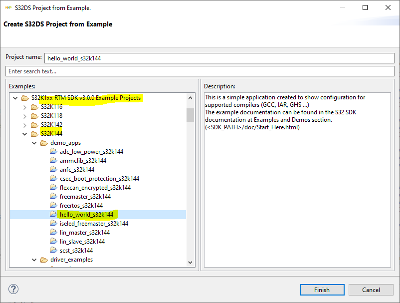

aniket_bagade
HI Marius,
                   I try to flash generated try1.mot file from flash from file option in S32DS. I have encountered this error.
under debugger option I have done following setting

Hello [email protected]‌,
The register message is not an issue right now. So I assume you have created an empty project for S32K144. The settings from this tab seems to be right and it seems to have access to the OpenSDA.
From the error message you have, it looks like it is not able to access access gdb.
To see if all the project settings are performed right, please import a project from SDK and try debugging that. Please go in S32DS to File -> New ->  Create S32DS Project from Example and try flash that.
If this works, on the same project you can change the elf with the one generated from Matlab.

aniket_bagade
Hi Marius
its working!
Thank you.
