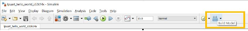

Hi team,
Why is not enabled the option "Build Model" in my application? Missing some plugin?
NXP example:

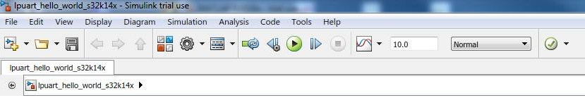

My example:

Hello lohrsistemas‌,
The build button does not appear because you probably don't have a license for Simulink Coder.
I must mention that even though our toolbox is free of charge, you will be needing some licenses from MATLAB (for Simulink Coder, Embedded Coder, Stateflow, MATLAB Coder). I see that you're using a trial license for Simulink - you could probably get a trial license for all those I mentioned and check out our toolbox.
Hope this helps,
Razvan.

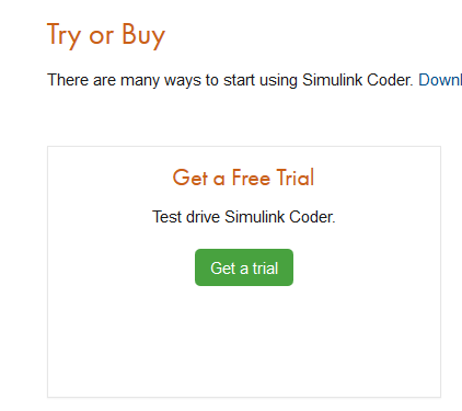

I do not really have a simulink coder license yet. I asked the staff at Math Works but until then I had no feedback.
Thank you for your feedback.

lohrsistemas
Hi Brian,
I requested a trial license, but until now I did not get a return, I do not know how to download Simulink Coder Trial.
