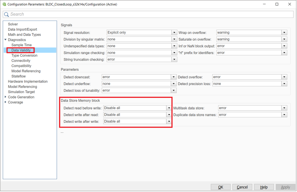

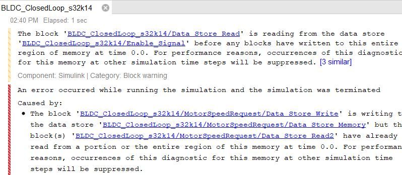

bonggyusong
Hi I am bong gyu
I builed simulink for S32K14 Model
I saw error message
What do i check ?
I want you to help me !
1,677 Views
Daniel_Popa
Hi bonggyusong‌,
You can disable these errors from the Simulink Configuration Parameters/Data Validity.pastedImage_1.png
Alternatively, you can modify the model to include a unit delay between read and write data blocks.
Hope this helps!

paulvlase
Hi bonggyusong‌,
You can set different priorities for Data Store Read and Write blocks. Open the block properties dialog for the Data Store Write block and set 1 for the highest priority. Smaller numbers have higher priority. This way Data Store Write block will run before the Data Store Read block.
You will find more info here Control and Display the Sorted Order- MATLAB & Simulink .
