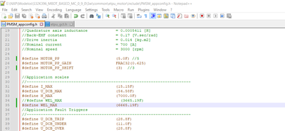

Hello @MayurB51 , sorry to bother you but this topic is still open. The code does not respond to a change in resolver pole pair. Moreover is it limiting the maximum electrical speed to around 3600rad/s. So, i try to modify the WEL_MAX variable in the appconfig.h but nothing change also.
Can you please help me with this topic? Thanks.

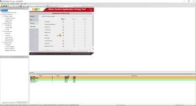

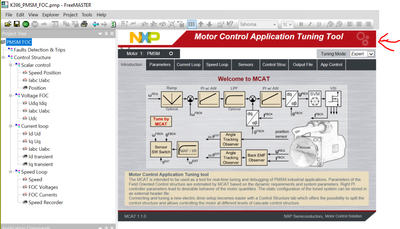

Can you please try the below method to change the resolver setting in freemaster:
first you need to open the freemaster, click on the below icon.

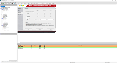

then you have to go to the "Sensors" option as shown below and have to click on the checkbox of the Resolver or the sensor you want to use.
After above step you have to click on the "Tab menu" and check the checkbox of "Sensors" option as shown below:
After all these steps you have click on the "Apply" and "OK" button and you will see a new window with the name of "Sensors" will apear where you can do changs the Resolver parameters.
after all these changes you can "Update Target", "Store Data" and go to the "Output File" menu and "Generate Configuration File". Go to S32DS Build, compile and flash the code again.

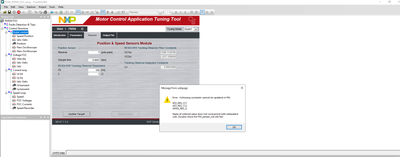

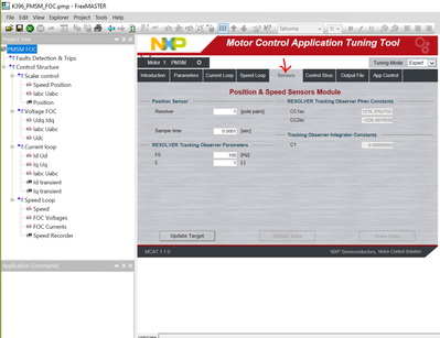

agus_idiada
Thanks for the answer @MayurB51, I tried your suggestion without success. I got an error when I follow your steps (fig 2). I also noticed that there is not any variable in the data dictionary referring the Resolver parameters (fig 3). Maybe I can directly change them manually in the code if you can guide me where. Thanks.
