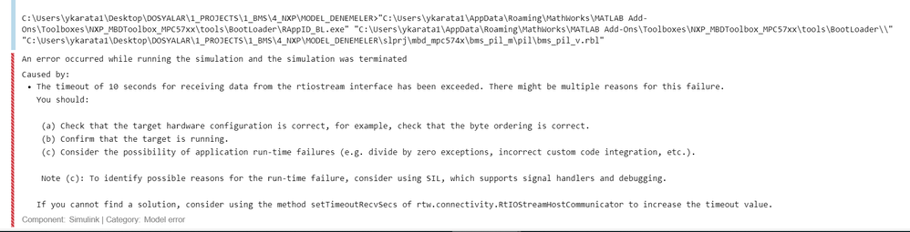

Hello everyone,
I have a complex Simulink model on my computer. When I want to use SIL, i can make it operate. It works great.
When I convert it to PIL, it gives me, error that I have shared related image below. By having in my mind that I can make a simple PIL model in the same processor and using same configuration in both simple and complex model, I do not think that Causes a and b is not the problem.
I think Cause c is the real problem here. If so,
Since C code is generated in SIL also, What is the problem with PIL? Both generates C code and implement it. SIL operates C code on my computer, PIL operates C code on Processor.
For detecting subsystems that prevent PIL from operating, I created a blank model and added subsystem of complex model one by one and tried PIL method for each step. My goal was detecting subsystems that is not suitable with PIL. But I have an enormous model and that takes a lot of time. Also since PIL has it own rules, it takes great effort at each step.
My Questions here are:
1. Why PIL do not operate while same model operate succesfully at SIL ?
2. How can I learn, debug easily which subsytem causes PIL to not work ?
Thanks.

I understand your frustration, but there is no simple answer I can give on why it is not working in PIL mode. The timeout can be caused by more factors so it would be helpful if you could give us more details regarding the model: are you using any peripheral blocks? Are you using blocks for interrupts? Do you know if the application has crashed? (here it might be helpful if you had an LED blinking just to let you know if it's still working).
While SIL is code generated on your computer, when it comes to PIL there are other factors that come in play - such as the connection between the MCU and the PC where you are running Simulink. Sometimes this causes an issue; other times, interrupts are getting in the way of this or better yet, sometimes interrupts are enabled on a certain peripheral that was not yet configured, and that causes the application to crash. This are just a few things that come to mind when talking about PIL issues.

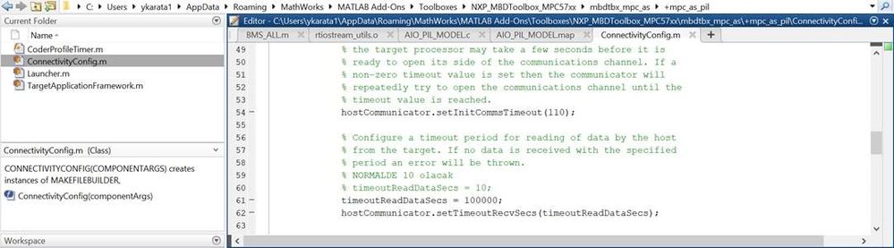

ykarata1
Dear constantinrazvan.chivu‌ paulvlase‌,
Thanks for your effort. I am trying to solve the problem still.
I also focused on timeout. I tried to change timeout by changing ConnectivityConfig. But despite of changing it, I got the error and error still says that timeout is still 10 seconds.
From that, I understand that I could not change timeout. Also I have looked for local project file to find that timeout value to change.
Thanks.

I suspect the timeout is just an effect, not the cause. There might be something that crashes the application; 10s should be enough to start the connection between Simulink and the target.

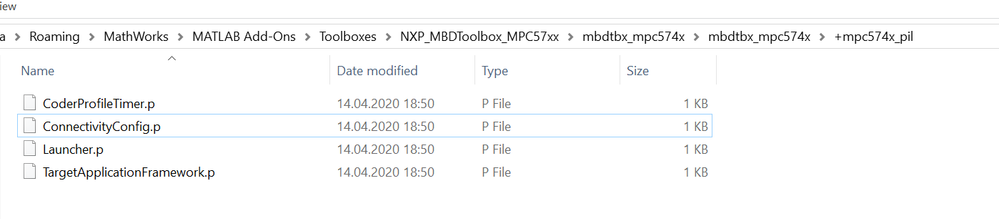

You changed the PIL communication timeout in the AUTOSAR PIL ConnectivityConfig.m file.
If you are not developing an AUTOSAR application, you have to change that timeout in
fullfile(mbd_find_mpc_root(), 'mbdtbx_mpc574x', 'mbdtbx_mpc574x', '+mpc574x_pil', 'ConnectivityConfig.m')
Run this command in the Matlab console to get the full path.
Are you able to run our simple PIL simulation example, sim_pil_top_mpc574x.mdlsim_pil_top_mpc574x.mdl, found in fullfile(mbd_find_mpc_root(), 'MPC_Examples', 'common', 'pil')?

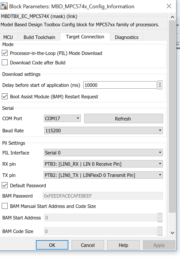

Can you post a screenshot of the Target Connection tab from the MBD_MPC574x_Config_Information block from your model?

ykarata1
Dear paulvlase and constantinrazvan.chivu,
1. I only have .p files which I can not see its inside and change it. As far as I understood they are coded and can not be decoded.
2. I can succesfully run sim_pil_top_mpc574x.mdl.
Figure 3: Target Communication of my model
Thansk.

Oops! I forgot to check if non-autosar ConnectivityConfig is pcode in the mltbx. Delete ConnectivityConfig.p and use the attached ConnectivityConfig.m instead.

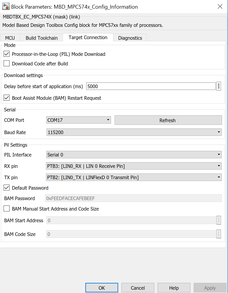

The settings from the Target Connection look good. Can you try to lower the Baud Rate to 57600?

We have changed timeout by ConnetivityConfig.m file that you have sent but problem exists still. Hopefully we have eliminated one possible cause.
We do not know why PIL does not work while SIL works.
Thanks again.
