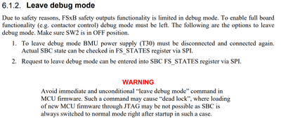

I'm working with S32K358 and contactors and need to set the SBC to normal mode, but it is stuck in debug mode. When I switch off the SW2 and disconnect and reconnect the power, it keeps restarting and never enters normal mode. How can we request to leave debug mode with SBC FS_STATES if that's necessary? Also, is it possible that there is a dead lock as mentioned below?
