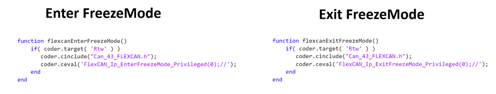

To put the FLEXCAN module into FreezeMode, we can use the S32K3 RTD functions:
  • FlexCAN_Ip_EnterFreezeMode_Privileged(uint8 instance)
  • FlexCAN_Ip_ExitFreezeMode_Privileged(uint8 instance)

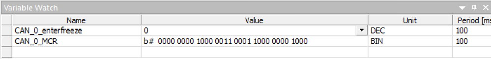

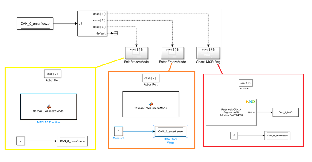

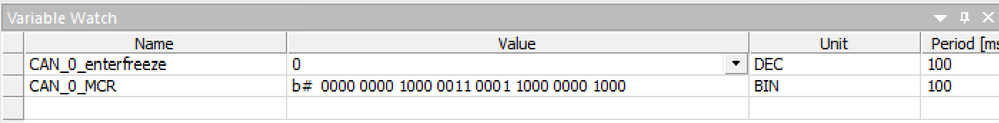

To test this I've added the following blocks to an already existing model that sends messages over CAN. Basically, I have a variable CAN_0_enterfreeze which I modify from the FreeMASTER to have one of the following values:
  • 0: Do nothing
  • 1: read MCR register for CAN 0 instance and store the result in CAN_0_MCR
  • 2: Enter FreezeMode
  • 3: Exit FreezeMode
Inside case 2 and case 3, you have to add a MATLAB function block. The custom code to enter/exit freezemode can be found below:
To validate this I've done the following:
  • Reset the development board and read the content of MCR register for CAN 0 instance.

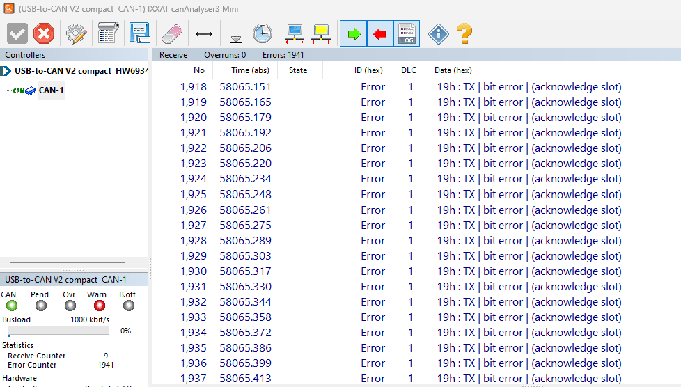

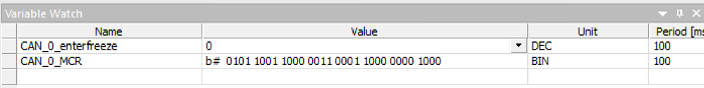

  • Set CAN_0_enterfreeze to 2 and read the content of the MCR register. Note! The FlexCAN is not working in FreezeMode.SorinIBancila_3-1754053812864.png

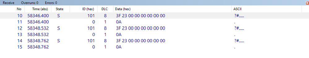

  •  Set CAN_0_enterfreeze to 3 and read the content of the MCR register. The CAN is working again. I just send a message (ID = 101) from CAN analyzer tool and the board replies with a message ID=0.
The S32K3 RTD sources can be found inside the toolbox, where you can check the implementation for a specific module in case you need it. To open the root of the S32K3 folder, you can type the following command in MATLAB command window : cd(mbd_find_s32k3_root).
