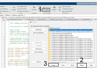

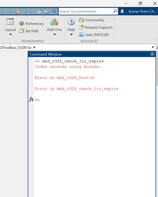

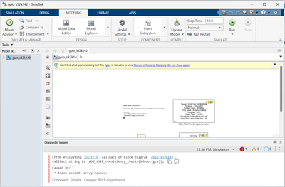

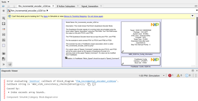

premch2301
at the last step of verify MBT license: this error is showing that index exceeds array bonds

premch2301
see i think there is some issue with the license file only

SorinIBancila
I have a clean S32K1xx toolbox installed and I am not able to reproduce your problem. Did you bring any modification the example? What MATLAB version do you use?
From the previous post, I see that you use the S32K1xx v4.3.0? Am I right?

premch2301
while installing MLTBX file, i am facing problem on the last step(verify MBD toolbox license).  due to that it is not installing completely.
MBT version:
4.3.0 Model-Based Design Toolbox for S32K1xx Automotive Microprocessors Family
MATLAB version: R2024b
boot serial no: 92E107F3
license file : (.dat)
#Model-Based Design Toolbox for MATLAB/Simulink - Model-Based Design Toolbox
#for S32K1xx Automotive Microprocessors Family for Prem chanchal Software
#Account
# License for DISK_SERIAL_NUM=92E107F3 laptop
INCREMENT MC_Toolbox_S32K freescale 1.0 26-mar-2045 uncounted \
VENDOR_STRING="Model-Based Design Toolbox for S32K1xx \
Automotive Microprocessors Family" \
HOSTID=DISK_SERIAL_NUM=92e107f3 ISSUER="Freescale \
Semiconductor" ISSUED=02-apr-2025 ck=209 SN="FSL - 16070981" \
TS_OK SIGN="010D EDBB 08E4 D16D 281A 2570 AEB1 3280 2DBC 5852 \
2D0D 3BDF A9F0 32F4 75C3 1DB9 CF8C EE59 7D39 3F0F 61FE BD61 \
6119 AD4D C9B9 EEF8 9348 7117 20FE 82BF"

SorinIBancila

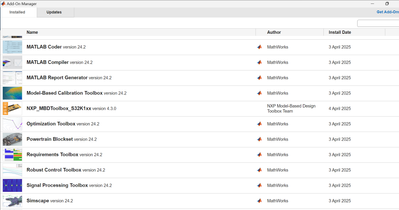

Unfortunately I am unable to reproduce your problem. No matter what I try, I can't get the same error.
In one of your screenshots, I saw that you have multiple S32K1xx toolboxes installed. Please make sure only on in installed.

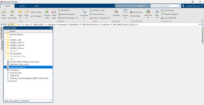

Can you try these steps, maybe they solve the problem:
1. Revert the MATLAB Path to the Default one.
2. Uninstall all S32K1xx toolboxes. Navigate to the C:\Users\TPEM_USER_1\AppData\Roaming\MathWorks\MATLAB Add-Ons\Toolboxes and delete all NXP_MBDToolbox_S32K1xx folder.
3. Restart MATLAB.

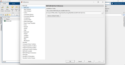

4. Go to Preferences -> MATLAB -> Add-Ons and modify the default installation folder to a shorter path and without including spaces . (e.g. C:\MATLAB\Addons\Toolboxes\R2024B)
5. Inside the MATLAB, navigate to the NXP_MBDToolbox_S32K1xx_4.3.0_20220913.mltbx file and double click on it and install the toolbox.
6. Manually activate the toolbox by copying the license.dat file inside the lic folder.
7. Run the mbd_s32k_path script.
Let me know if these steps solve your problem.

premch2301
i have installed only one S32K1xx add on tool. followed all the above steps.  Still this issue is coming
3,788件の閲覧回数
premch2301
there is something issue with the license file.
