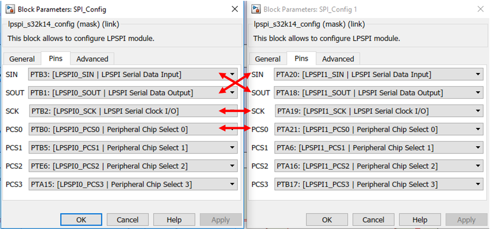

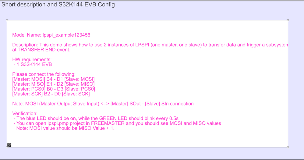

I am trying to adapt the S32K144 LPSPI example to the S32K148 board.
The connections as described in the example is as follows:
I have made the following changes but no success:
[Master: MOSI] B1 - A20 [Slave: MOSI]
[Master: MISO] B3 - A18 [Slave: MISO]
[Master: SCK  ] B2 - A19 [Slave: SCK  ]
[Master: PCS0] B0 - A21 [Slave: PCS0]

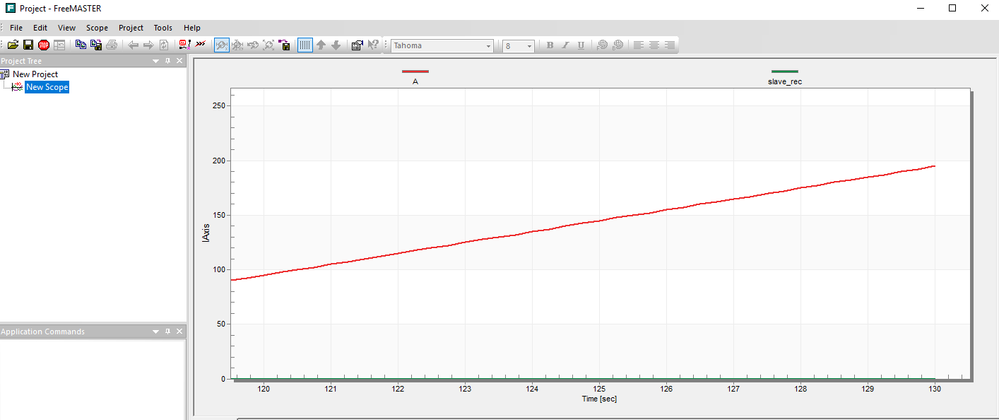

By Freemaster, I always get the value of A to increment, meanwhile the slave receive value is always 0

I've tested your model and the master outputs the correct signals (observed on the oscilloscope) but the slave does not respond. The settings are correctly set, but there seems to be a problem with the pin usage - if I use the following pins, the model works as expected:
Master (LPSPI0)                           Slave(LPSPI1)
   (SIN)     PTE1                                (SIN)     PTD1
   (SOUT) PTB1                                (SOUT) PTD2
   (SCK)    PTB2                                (SCK)   PTD0
   (PCS0)  PTB0                                (PCS0) PTD3
I have attached the model with the LPSPI configured with these pin settings. I will try and find what is the problem when using the pins that you initially configured. There may be a mismatch between the board and the schematic or some other problem. I will post back here when I find out what exactly triggers this behavior.
