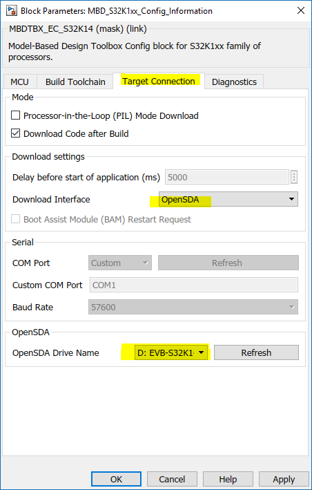

mariuslucianand
Hello  渉 久保田,
Looks like the program fails to copy the lpuart_hello_world_s32k14x.mot file to the mounted S32K144 EVB.
Firstly you need to open the config block, go to Target Connection tab and under the OpenSDA, please select the right disk mount of the board. If is set on Custom, just press the Refresh Button and select the right one (On my machine it is mounted as drive D).
Please try this approach and if this is not working, please go to C:\Users\AAA\Documents\MATLAB\Add-Ons\Toolboxes\NXP_MBDToolbox_S32K1xx\S32_Examples\lpuart_hello_world_s32k14x_mbd_rtw\lpuart_hello_world_s32k14x.mot and manually copy the .mot file on the disk.
Hope this helps,
Marius
2,153 Views
wataru_kubota
Hi, Marius Lucian Andrei,
Thank you for your reply.
I checked the settings, but the settings for "Target Connection" were not wrong.
How do I manually copy mot files to disk?
By the way, I forgot to tell you that the matlab version is R2019a.(OS: Win10 x6)
