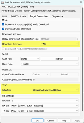

The easiest workaround is configuring, in the NXP configuration block of Simulink, the "Download interface" to JTAG and the JTAG interface to "OpenSDA Embedded Degugger".
In this way, the firmware will be loaded directly with JTAG, without the use of the drag and drop function.
