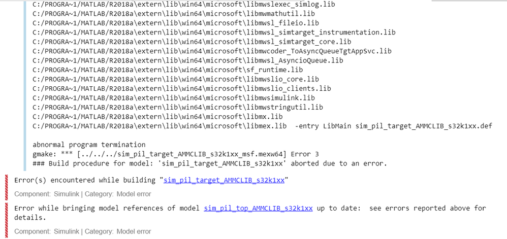

This is Ozan. I am using S32K144Q100 EVB and MBDT v 4.2. I want to try processor in the loop (pil) example of s32 library. I used sim_pil_top_AMMCLIB_s32k1xx example model but I encounter with a problem. The print screen of error and couple of log line are provided below. I could not understand the reason and how can I solve this problem and work on pil examples?
Also when I try to implement my own example project about PIL system I encounter different error. When I run my model I received the error "'cp' is not recognized as an internal or external command, operable program or batch file." The screen-shots of error and my configurations (I used same config block for both example) is provided below. I think that both problem are related and I should mentioned about both of them. Any help will be appreciated thanks in advance.

As constantinrazvan.chivu‌ already pointed out, the lcc compiler shipped with Matlab fails to build models that contain AMMCLIB blocks because it doesn't support latest C language standards. To run PIL simulations you need to install the MingW compiler from the Matlab Add-On Exlorer.
Let us know if installing MingW compiler fixed your issues.

I install the MingW compiler from adds-on. But this time I encounter with different error and the model still does not work. I am using Matlab 2020a and mbdt v4.2. Also I changed the s32k144 board boot-loader from openSDA to RappID thus I select serial mode and boot assist module (BAM). You can find the error code and relevant information as follow. Any will  will be appreciated thanks in advance.

I think the issue here is related to the compiler you are using: lcc. To fix this you should install MS Visual Studio or mingw.
paulvlase‌ can give you more details about it.
