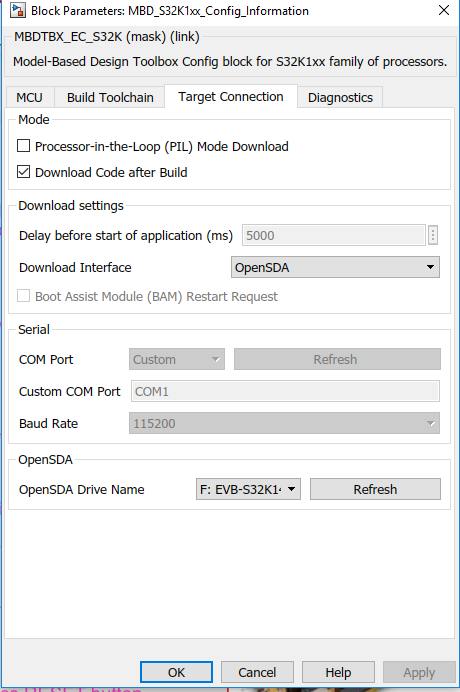

Hi NXP MBDT team,
I tried several times to generate the code of a basic example "gpio_s32k144.mdl" and download it to the board without success (the code is well generated but the download process did not accomplished: it hangs at the following step
*** Created executable: gpio_s32k144.mot
### Successful completion of build procedure for model: gpio_s32k144
For your information
I use Matlab release 2019a
NXP Model-Based Design Toolbox for S32K1xx – version 4.1.0
The board is well connected and detected
In target connection i tried to refresh the OpenSDA Drive Name =>  without success
I have selected OpenSDA Drive Name "F:EVB-s32k144 =>  without success
I tried also to type in the the corresponding Custom OpenSDA Drive Name => without success
I have copied the gpio_s32k144.mot directly to the board  => without success
With all the previous steps i can not run any application
Could you please help me to resolve this issue
Thanks in advance for your support

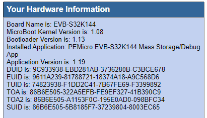

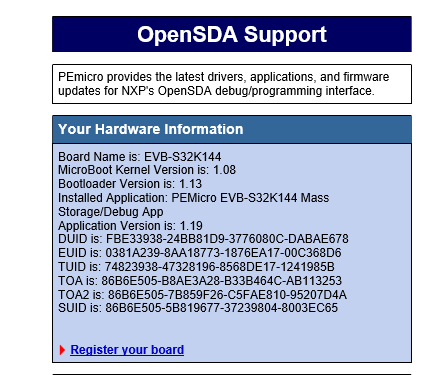

Hello [email protected]‌,
The OpenSDA contains an SDA_INFO.HTM. Can you please send me the content displayed under "Your Hardware information" like here:
You can try at the PEmicro website to see if there are any updates for the OpenSDA.
Also, you can try flashing the gpio generated mot file with the S32DS to see if the generated code works as expected. You don;t need to import the project, just flash the generated .mot file.

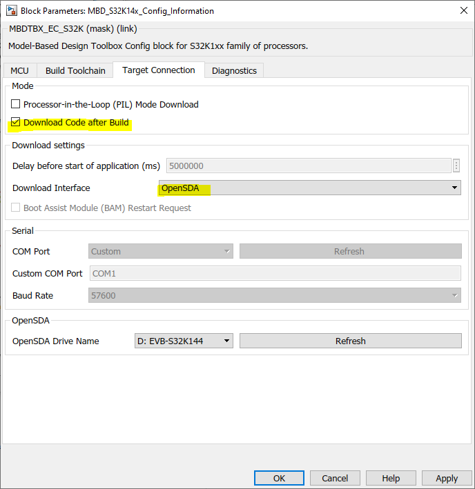

mariuslucianand
As far as I understand from your post, the .mot has been successfully generated.
The refresh button will look for all the mounted devices, it will not select the one you need.
This is how it looks for me.

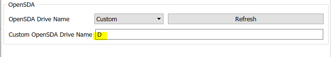

For the custom SDA name you need to type only the letter fo the mounted Drive. In my case is D, your case F
From this reason I assume there is a problem with the board, maybe the jumpers are not right set. Make sure the S32K is powered up. For reset jumper, the J104 must be connected 1-2. If you want to power the CPU from the USB then the J107 must be set 2-3. If you want to power up the controller from external sources the J107 must be set 1-2.
Marius

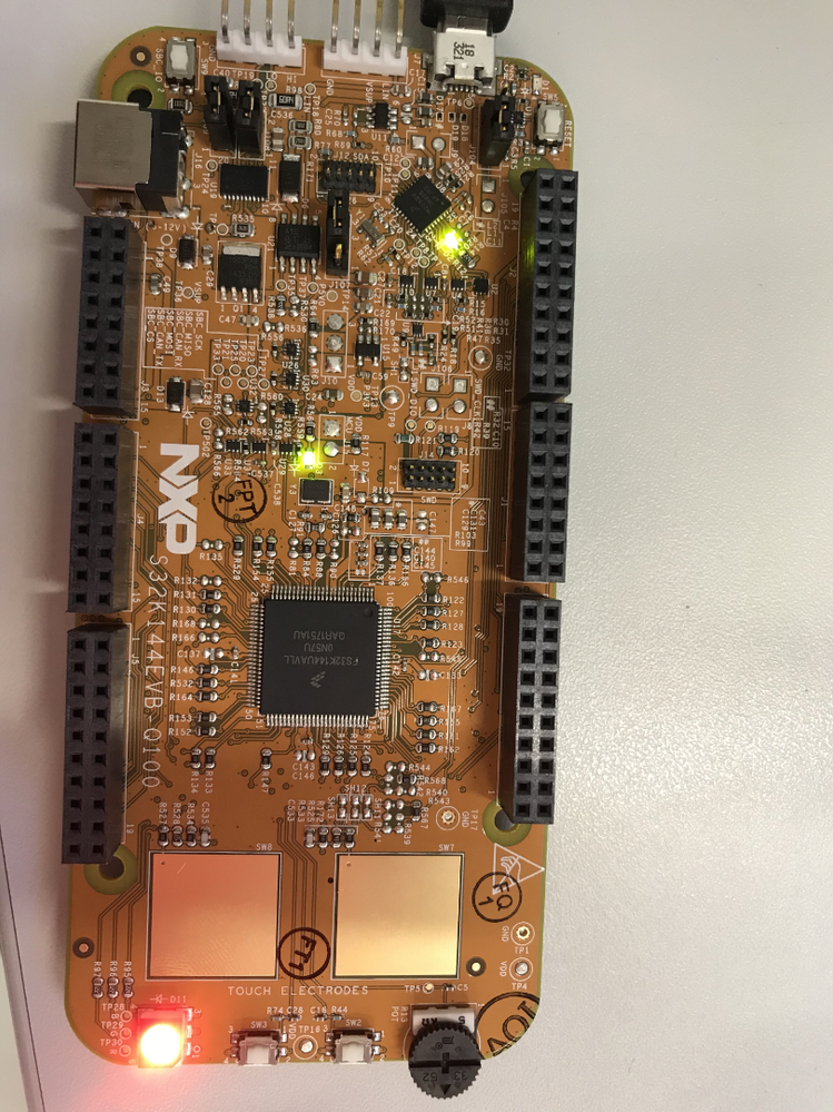

mohamed_benderr
You find blow thea photo of your S32K144EVB jumper setup
6,568 Views
constantinrazva
And [email protected] ,
Can you also share with us a photo of your S32K144EVB jumper setup? And maybe a photo with the revision you have, just so we can replicate the exact scenario you are using.
