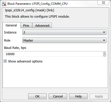

I want to use the SPSPI on the S32K144, but I don't can't figure out how to transmit data to a specific peripheral using the Peripheral Chip Select 0 - 4 lines.
For example I want to use LPSPI2, so I'm using the lpspi_s32k14_config block.
Since I want to use the LPSPI2 I select "Instance 2"
And the Advanced configuration allows me to select the Peripheral CS (in this case let's say I want LPSPI2_PCS2), so I select "Peripheral CS = 2"

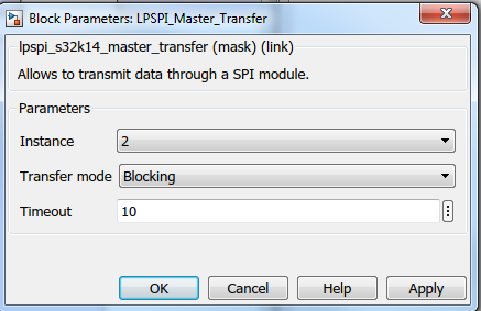

But when I want to set the lpspi_s32k14_master_transfer block, I only have the option to select the Instance.
In this case I selected Instance 2
But what about using the other Peripheral CS on the same instance. Let's say I want to transmit to the Peripheral 0 for Instance 2?
If I duplicate the lpspi_s32k14_config block and change the "Peripheral CS = 0", I get this error:
Error duplicating of the LPSPI2 configuration block 'main/LPSPI_Config_COMM_CPU '. The block should be only one
How can I control each Peripheral Chip Select for any given LPSPI instance?

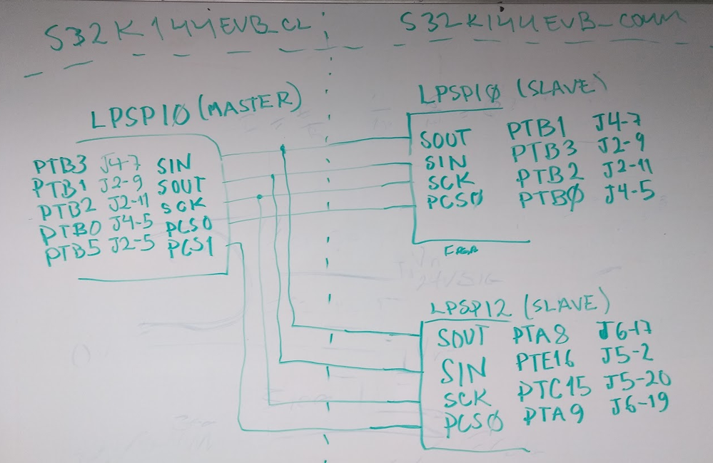

After checking out the LPSPI as Master one instance and the four PCS; I started testing the LPSPI now in Slave Mode, and I'm using two S32K144EVB boards and I'm utilizing two LPSPI instances as Slave. I'm using the "Dedicated slave select lines scheme" as described in page 1439 of the S32K1xx Series Reference Manual, but in this case I'm using only two SPI Slaves.
So I wired the two S32K144EVB as follows
I didn't want to use LPSPI1 because some pins are shared with the onboard SBC used for CAN, so I choose to utilize LPSPI0 and LPSPI2 and wired them as shown in the picture from the whiteboard.
I found the following while doing the S32K144EVB_COMM side (2 LPSPIs):
  • My first issue I found was on the PCS3 lines for this two specific instances, the microcontroller used on the S32K144EVB has the same pin for both LPSPI0_PCS3 and LPSPI2_PCS3 defied as PTA15. But that's ok, at least for this test I'm using only PCS0 on both LPSPI0 and LPSPI2, which are PTB0 and PTA9 respectively. But when I wanted to build the software I got the following error:pastedImage_3.png
    So, since I already knew that the conflict was on PCS3 (which I'm not using), I disabled the "Diagnostics" for the LPSPI on the MBD_S32K14x_Config_Information block. But for Slave mode, you'll be using only one of the available PCS lines on any given interface.
  • My second issue, and the most important I think, is when I connected the SOUT lines from LPSPI0 and LPSPI2 from the S32K144EVB_COMM (Slave) to the S32K144_CL (Master) board. I wasn't getting any valid data to the Master from the Slaves, analyzing the SOUT signal on an oscilloscope found that the line was being pulled down. Digging out in the S32K1xx Series Reference Manual I noticed the field OUTCFG on register CFGR1, if 0b - Output data retains last value when chip select is negated, else if 1b - Output data is tristated when chip select is negated. So I looked into the generated code and noticed that the OUTCFG is being set as 0 (LPSPI_DATA_OUT_RETAINED) in function LPSPI_SetPinConfigMode inside LPSPI_DRV_SlaveInit.
    So I imported the generated C code into S32 Design Studio for ARM and changed the following code inside the LPSPI_DRV_SlaveInit function:
    (void)LPSPI_SetPinConfigMode(base, LPSPI_SDI_IN_SDO_OUT,
                    LPSPI_DATA_OUT_RETAINED, true);
    to
                    LPSPI_DATA_OUT_TRISTATE, true);
    So, this solved the problem. After confirming my hardware teammate this was causing the SOUT lines to be in conflict and needed to be tristated when PCS not active.

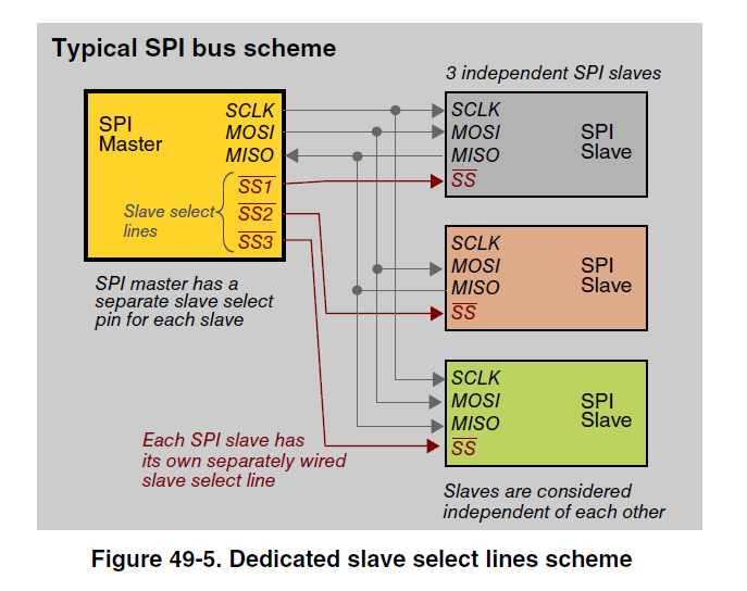

We have 3 SPI slave devices (a DAC, a FPGA and another S32K board) that we need to communicate to using the same LPSPI interface on the S32K, so I need to have control on the peripheral I'm sending the data over SPI.
Since this is a design that we want to carry for more than one project, I'd like to take advantage of this feature and utilize the dedicated LPSPI PCS lines for the given interface, so in the future when the new release of the MDB Toolbox happens we would be able to integrate the simulink blocks without having to modify our hardware or carry the control of the alternate setCS functionality; because, if I understood correctly, I won't be able to utilize any of the PCS outputs from the LPSPI interface. At least not the ones defined on the  lpspi_s32k14_config block, on the "pins" tab, I'm I right on this assumption?

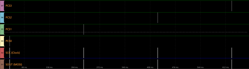

I tested the hotfix you sent me for selecting the PCS lines independently and is working as expected.
I setup a quick test program with the S32K144 with LPSPI Instance 0 as Master at 100000 bps. And I see the PCS0 - 4 lines being activated accordingly.
Once again thank you very much for your support.
