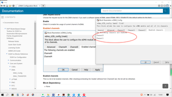

S32K1 MDBT eMDA_config “enable chanels”invalid
754 Views
Yuanbao
SW  :  S32K144EVB-Q100
HW :  matlab2023a
MBD :  NXP_MBDToolbox_S32K1xx_4.3.0

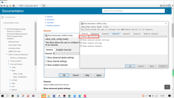

question1:no matter how change  General_channel,"Enabled channels" alway is channel0 and channel1.
question2:change General_channel 0→3→0,dialog box “channel1~2” still show
question3:how to eMDA for FlexCAN0/FlexCAN1 FIFO?
