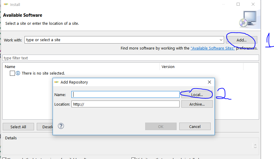

First, you will need to install an update for MPC574x-P SDK. You can find it at the same link as the S32Design Studio (see the picture below).pastedImage_4.jpg
To install this update, you will have to download the .zip file, then extract it into a folder. From there go to Help -> Install New Software (in Design Studio).
From there select Add, then Local, and browse to the folder that you unzipped the update that you downloaded.
After this step, you will be asked to restart the S32 Design Studio.
Now you can create a new S32DS Project and select from the MPC574x-P family the MPC5744P. Now if you click on SDKs, pastedImage_1.jpg
you should be seeing the MPC5744P SDK. Select it, and if you create a project and add a component, after generating the code for it you should see the SDK folder of your project populated with the respective drivers.
