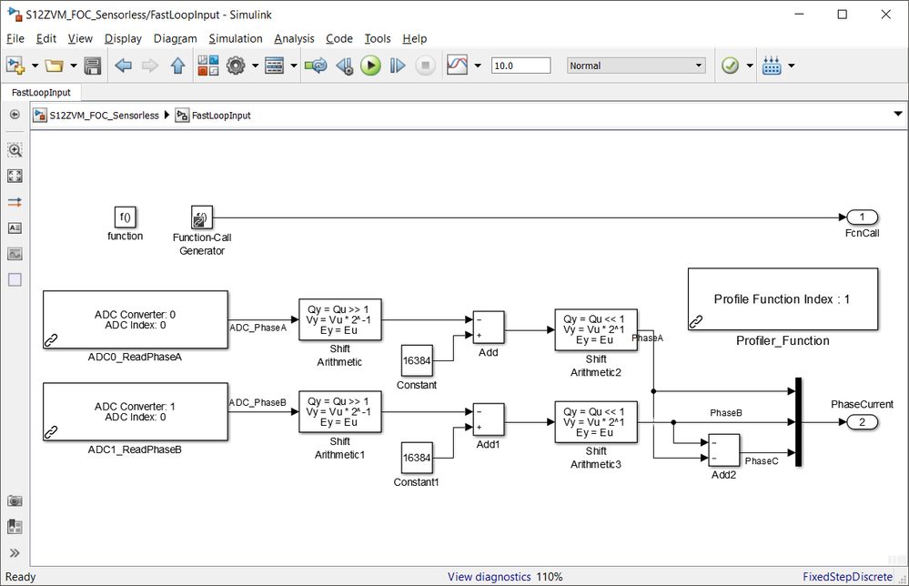

    The example model: S12ZVM FOC Sensorless Motor Control is with one current shunt or two current shunt?
    In the ADC0_Command_List model and the ADC1Command_List, the Input Channels are all 16. I am confused.

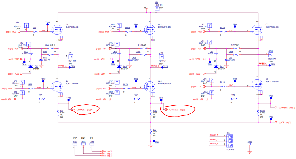

The FOC model for ZVM is using a dual shunt current measurement method.
Inside the FastLoopInput subsystem, there are 2 currents IA, IB that are read from ADC0 and ADC1 respectively.
From the board schematic, we are reading the I_PHASEA and I_PHASEB

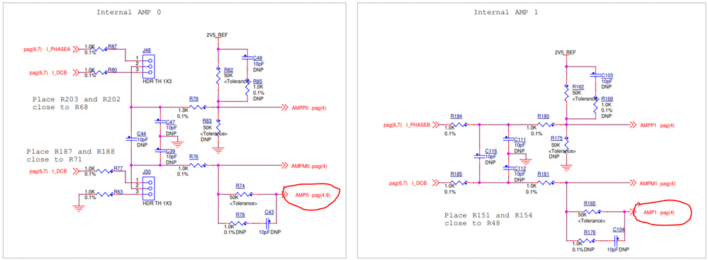

These 2 shunt drop voltages are routed to AMP0 and AMP1 pins

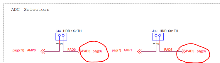

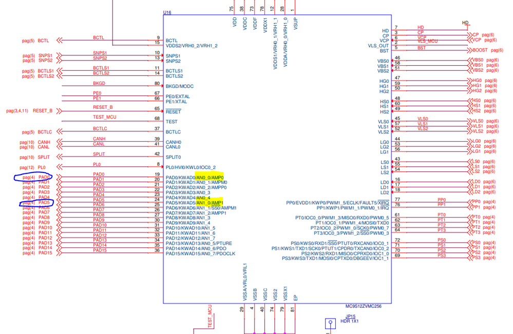

That are feed via PAD0 and PAD5 into the microprocessor
These input pins corresponds to ADC0 -> AN0_0 and ADC1 -> AN1_0 channels:
According with ADC Select table, AN0_0 and AN1_0 corresponds to value 16.
This is why you see ADC input channel 16 for both ADC lists.
Both ADC0/1 are read in the same time.

The internal AMP1 is disable, I think  Phase B current is sampled by External Amplifier (Phase B).
