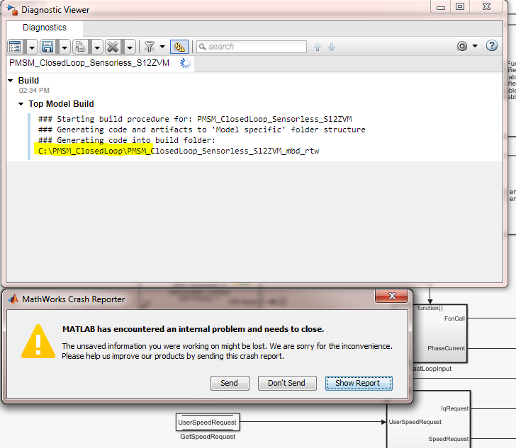

Dear Team,
I have successfully installed the new toolbox version 1.4 for S12Z.
The bootloader version 1.6.2.14 is not up to date in the folfer "\MATLAB Add-Ons\Toolboxes\NXP_MBDToolbox_S12ZVMx\tools\BootLoader"
So I install the new version 1.6.7.35.
Firstly I tried with the example "MATLAB Add-Ons\Toolboxes\NXP_MBDToolbox_S12ZVMx\S12ZVM_Examples\s12zvm\adc\adc_s12zvm.mdl".
After some adaptions on COM-port in "Configuration Parameters/PIL and Download Config", I can build successfully and download the application. The LED blinks.
Now I try with the next example model "\MATLAB Add-Ons\Toolboxes\NXP_MBDToolbox_S12ZVMx\S12ZVM_Examples\s12zvm\mc\PMSM_Demo\PMSM_ClosedLoop\PMSM_ClosedLoop_Sensorless_S12ZVM.mdl"
Because of too long name, there is a build error: "Build failed because the build file name(s) exceed the Windows limit of 260 characters"
So I change to a shorter name "PMSM_Sensless.mdl"
But Matlab crashes everytime I tried to build the model. (Simulation works without errors)
Please see the attached crash-report (crash_report.txt not allowed, so I do a zip)

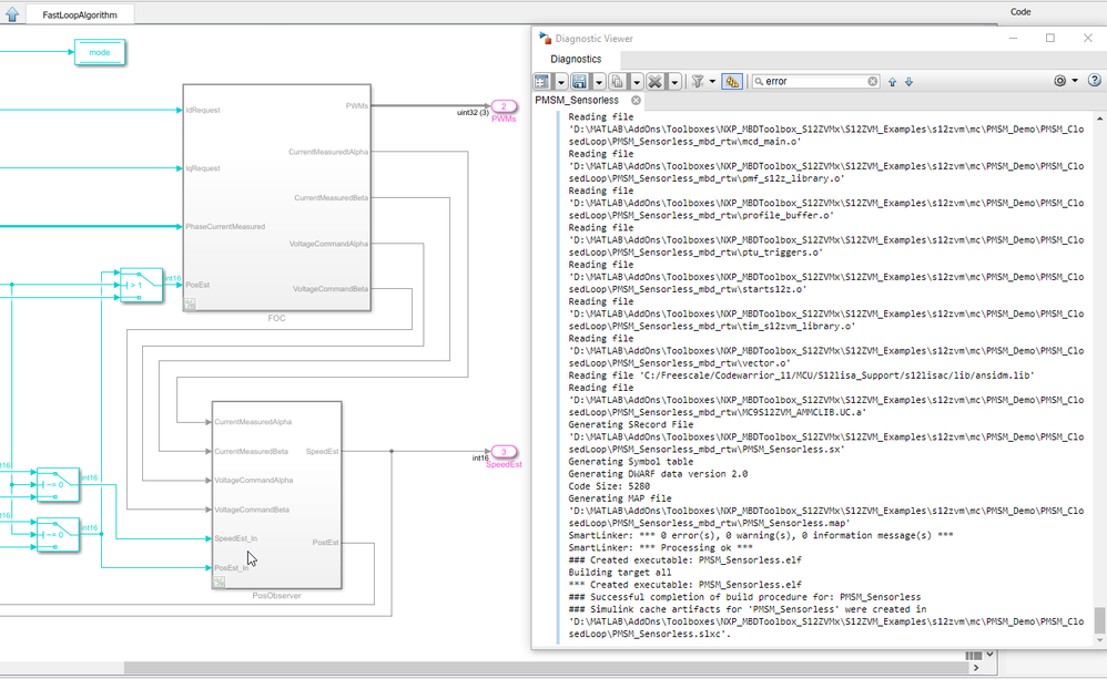

Step 3:
Comment out "AMCLIB_BemfObsrvDQ_F16"
Build successfully, no errors.
Do you have any ideas, what I could do?

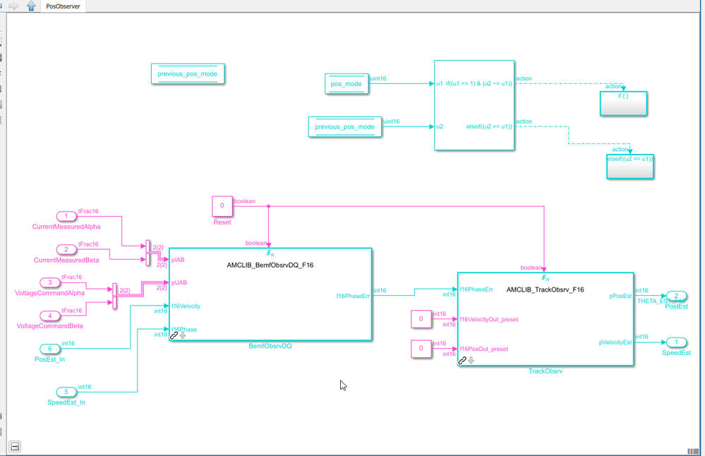

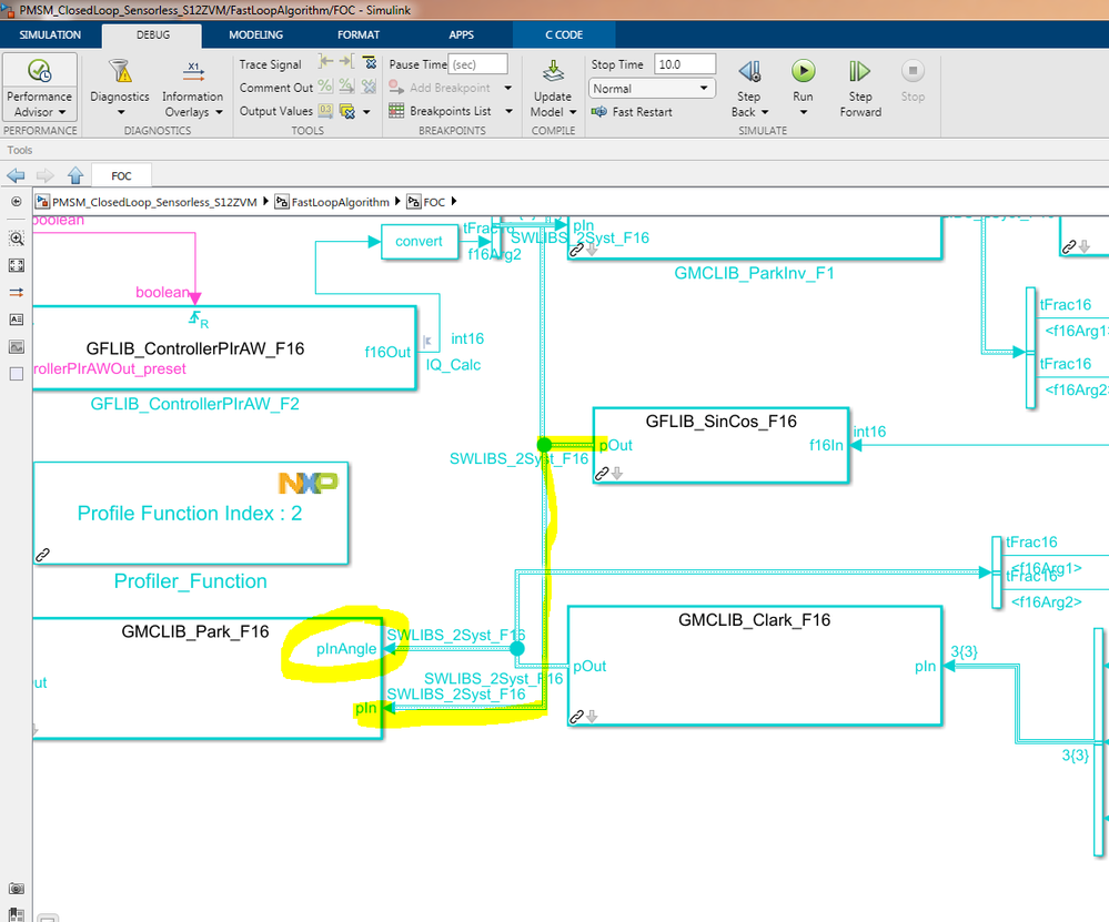

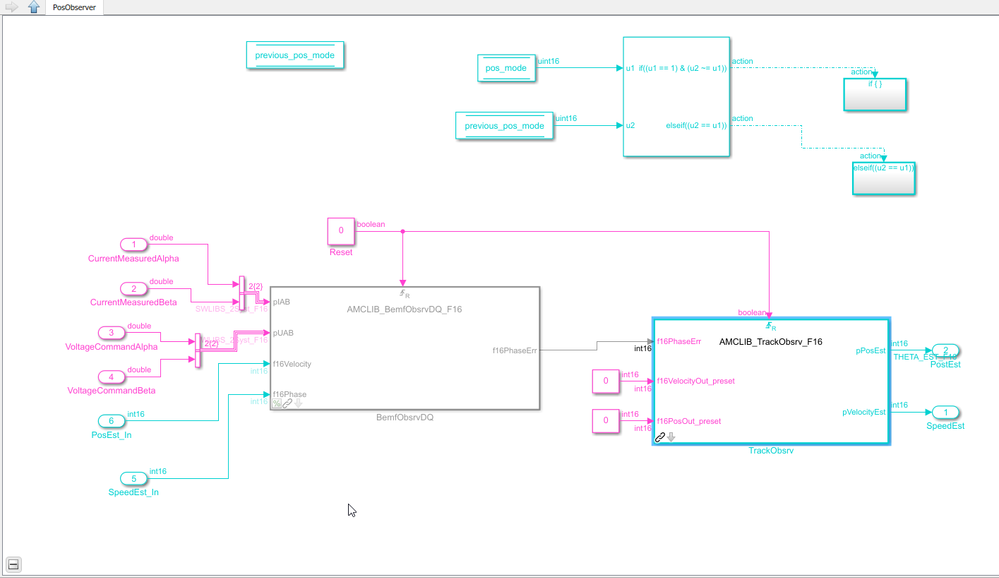

Step 1:
Because with the example model "PMSM_ClosedLoop", when I comment out both the "FOC" and " PosObserver"-Blocks, then I can build the model successfully:
Without FOC/Observer: OKWithout FOC/Observer: OK
Step 2:
Firstly activate only the "PosObserver", but remodeling with the lib-bocks: "AMCLIB_BemfObsrvDQ_F16" and "AMCLIB_TrackObsrv_F16". Name changes to shorter names: "BemfObsrvDQ" and "TrackObsrv":
Remodeling of ObserverRemodeling of Observer

Warning:Found legacy make variables |>S_FUNCTIONS<|, |>S_FUNCTIONS_OBJ<| in the template makefile D:\MATLAB\AddOns\Toolboxes\NXP_MBDToolbox_S12ZVMx\mctbx_s12zvm\mctbx_s12zvm\mcd_s12zvm.tmf. The variables are no longer required. You can remove the variables.
Warning:Found legacy make variables |>SHARED_BIN_DIR<|, |>SHARED_LIB<|, |>SHARED_SRC<|, |>SHARED_SRC_DIR<| in the template makefile D:\MATLAB\AddOns\Toolboxes\NXP_MBDToolbox_S12ZVMx\mctbx_s12zvm\mctbx_s12zvm\mcd_s12zvm.tmf. The variables are no longer required. You can remove the variables.
Error:
D:\MATLAB\AddOns\Toolboxes\NXP_MBDToolbox_S12ZVMx\S12ZVM_Examples\s12zvm\mc\PMSM_Demo\PMSM_ClosedLoop\PMSM_Sensorless_mbd_rtw>set MATLAB=D:\matlab2020a
D:\MATLAB\AddOns\Toolboxes\NXP_MBDToolbox_S12ZVMx\S12ZVM_Examples\s12zvm\mc\PMSM_Demo\PMSM_ClosedLoop\PMSM_Sensorless_mbd_rtw>"D:\matlab2020a\bin\win64\gmake" -f PMSM_Sensorless.mk COPY_MDLREF_INCLUDES=0 GENERATE_ERT_S_FUNCTION=0 INCLUDE_MDL_TERMINATE_FCN=1 COMBINE_OUTPUT_UPDATE_FCNS=1 MULTI_INSTANCE_CODE=0 INTEGER_CODE=0 CW_TARGET_DEFAULT_LCF=1 CW_TARGET_USER_LCF="mc9s12zvml128_FLASH.prm" CS_TARGET_DEFAULT_LCF=1 CS_TARGET_USER_LCF="mc9s12zvm32_FLASH.lkf" PIL_DOWNLOAD=0 RBL_DOWNLOAD=1 ISPROTECTINGMODEL=NOTPROTECTING OPTS="-DTID01EQ=0"
Cleaning...
RELATIVE_PATH_TO_ANCHOR is ..
==== Removing object files from build directory ====
Compiler details : "C:/Freescale/Codewarrior_11/MCU/S12lisa_Tools/Build_Tools/mwccs12lisa" -c -model small -bfield_lsbit_first -bfield_reduce_type -opt level=2 -opt speed -inline auto -requireprotos -Cpp_Exceptions off -char unsigned -msgstyle parseable -sym full -nostdinc -nosyspath -w possible -w extended -w extracomma -w emptydecl -w structclass -ansi off -ipa function -inline smart,auto,bottomup -bool off -wchar_t off -RTTI off -llong_size=8 -double_size 8 -lang c99 -gccext on -o SetupFiles -I. -I.. -I../instrumented -I.. -I"D:\matlab2020a\simulink\include" -I"D:\matlab2020a\extern\include" -I"D:\matlab2020a\rtw\c\src" -I"D:\matlab2020a\rtw\c\libsrc" -I"D:\matlab2020a\rtw\c\src\ext_mode\common" -I"D:\matlab2020a\rtw\c\src\ext_mode\tcpip" -I"D:\matlab2020a\rtw\c\src\ext_mode\serial" -I"D:\matlab2020a\rtw\c\src\ext_mode\custom" -ID:\MATLAB\AddOns\Toolboxes\NXP_MBDToolbox_S12ZVMx\S12ZVM_Examples\s12zvm\mc\PMSM_Demo\PMSM_ClosedLoop -ID:\MATLAB\AddOns\Toolboxes\NXP_MBDToolbox_S12ZVMx\S12ZVM_Examples\s12zvm\mc\PMSM_Demo\PMSM_ClosedLoop\PMSM_Sensorless_mbd_rtw -ID:\matlab2020a\extern\include -ID:\matlab2020a\simulink\include -ID:\matlab2020a\rtw\c\src -ID:\matlab2020a\rtw\c\src\ext_mode\common -ID:\matlab2020a\rtw\c\ert -I"C:/Freescale/Codewarrior_11\MCU\S12lisa_Support\s12lisac\include" -DTID01EQ=0
Assembler details : "C:/Freescale/Codewarrior_11/MCU/S12lisa_Tools/Build_Tools/mwccs12lisa" -CMacAngBrackOn -ViewHidden
Product: PMSM_Sensorless.elf
Build product type: executable
Building file FastLoopAlgorithm.o...
"C:/Freescale/Codewarrior_11/MCU/S12lisa_Tools/Build_Tools/mwccs12lisa" -c -model small -bfield_lsbit_first -bfield_reduce_type -opt level=2 -opt speed -inline auto -requireprotos -Cpp_Exceptions off -char unsigned -msgstyle parseable -sym full -nostdinc -nosyspath -w possible -w extended -w extracomma -w emptydecl -w structclass -ansi off -ipa function -inline smart,auto,bottomup -bool off -wchar_t off -RTTI off -llong_size=8 -double_size 8 -lang c99 -gccext on -o FastLoopAlgorithm.o -I. -I.. -I../instrumented -I.. -I"D:\matlab2020a\simulink\include" -I"D:\matlab2020a\extern\include" -I"D:\matlab2020a\rtw\c\src" -I"D:\matlab2020a\rtw\c\libsrc" -I"D:\matlab2020a\rtw\c\src\ext_mode\common" -I"D:\matlab2020a\rtw\c\src\ext_mode\tcpip" -I"D:\matlab2020a\rtw\c\src\ext_mode\serial" -I"D:\matlab2020a\rtw\c\src\ext_mode\custom" -ID:\MATLAB\AddOns\Toolboxes\NXP_MBDToolbox_S12ZVMx\S12ZVM_Examples\s12zvm\mc\PMSM_Demo\PMSM_ClosedLoop -ID:\MATLAB\AddOns\Toolboxes\NXP_MBDToolbox_S12ZVMx\S12ZVM_Examples\s12zvm\mc\PMSM_Demo\PMSM_ClosedLoop\PMSM_Sensorless_mbd_rtw -ID:\matlab2020a\extern\include -ID:\matlab2020a\simulink\include -ID:\matlab2020a\rtw\c\src -ID:\matlab2020a\rtw\c\src\ext_mode\common -ID:\matlab2020a\rtw\c\ert -I"C:/Freescale/Codewarrior_11\MCU\S12lisa_Support\s12lisac\include" -DTID01EQ=0 FastLoopAlgorithm.c
C:/Freescale/Codewarrior_11/MCU/S12lisa_Tools/Build_Tools/mwccs12lisa|Compiler|Error
(D:\MATLAB\AddOns\Toolboxes\NXP_MBDToolbox_S12ZVMx\S12ZVM_Examples\s12zvm\mc\PMSM_Demo\PMSM_ClosedLoop\PMSM_Sensorless_mbd_rtw\FastLoopAlgorithm.h|26|9|10|811|10)
=#include "gmclib.h"
>the file 'gmclib.h' cannot be opened
Errors caused tool to abort.
gmake: *** [FastLoopAlgorithm.o] Error 1
Error(s) encountered while building "PMSM_Sensorless"

Hi @adriantudor
I have recently tried to build the example: "\MathWorks\MATLAB Add-Ons\Toolboxes\NXP_MBDToolbox_S12ZVMx\S12ZVM_Examples\s12zvm\mc\BLDC_Demo\BLDC_ClosedLoop\BLDC_ClosedLoop_S12ZVM.mdl"
It works without any errors!

adriantudor
Hi @nofake_drstrang ,
I tried to build this example on my machine and it's ok. I recommend you to copy the "PMSM_ClosedLoop"  folder on your root (eg.: C:\PMSM_ClosedLoop). Be sure that the folder copied is not protected and it can be written (check in the folder proprieties). Then add this folder to the path using Matlab, then try to build it.
Adrian

Unfortunately it does not work
But when I comment out the FOC- and Observer- Blocks, then It works without crash.
I have Simulink/matlab 2020a. Your model is saved in R2019.
Many thanks!

adriantudor
@nofake_drstrang  Hi,
Try to reduce the length of the names of all blocks/subsystems that are included in the FOC- and Observer- Blocks (and even the names of those 2 blocks). Unfortunately, I can't try that on my machine because I don't have this issue. And please let me know if it works.
Thank you,
Adrian
13,332 次查看
nofake_drstrang
Hi @adriantudor
I tried but unfortunately it did not work. Same crash...

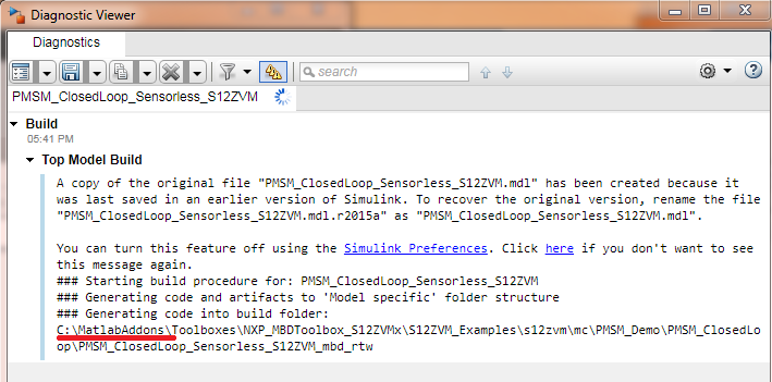

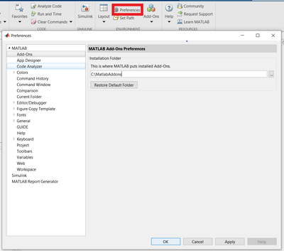

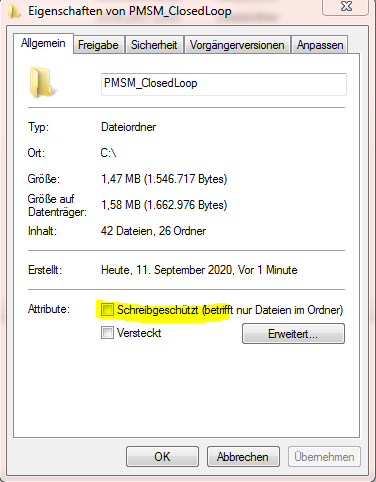

nofake_drstrang
Hello @adriantudor ,
thanks for your reply!
I tried your suggestion, but same crash...

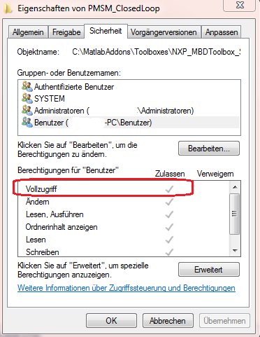

writeprotect.PNGwriteprotect.PNGsetpath.PNGsetpath.PNGMatlab_crash2.PNGMatlab_crash2.PNG
Crash Report:
MATLAB crash file:D:\TEMP\matlab_crash_dump.5236-1:
Access violation detected at Fr Sep 11 02:34:35 2020 +0200
Configuration:
Crash Decoding : Disabled - No sandbox or build area path
Crash Mode : continue (default)
Default Encoding : windows-1252
Deployed : false
Graphics Driver : Unknown hardware
Graphics card 1 : NVIDIA ( 0x10de ) NVIDIA GeForce GTX 460 Version 10.18.13.5582 (2015-8-25)
Java Version : Java 1.8.0_202-b08 with Oracle Corporation Java HotSpot(TM) 64-Bit Server VM mixed mode
MATLAB Architecture : win64
MATLAB Entitlement ID : 6257193
MATLAB Root : C:\Program Files\MATLAB\R2020a
MATLAB Version : 9.8.0.1323502 (R2020a)
OpenGL : hardware
Operating System : Microsoft Windows 7 Ultimate
Process ID : 5236
Processor ID : x86 Family 6 Model 42 Stepping 7, GenuineIntel
Session Key : 5d89cee5-8153-411a-a8a1-62f21120602f
Window System : Version 6.1 (Build 7601: Service Pack 1)
Fault Count: 1

paulvlase
Can you try to install the latest Matlab R2020a update?
Here are the instruction to do that: https://www.mathworks.com/downloads/web_downloads/download_update?release=R2020a&s_tid=ebrg_R2020a_2...
Also you could try to change the location of the Matlab Add-Ons folder from Matlab Preferences -> MATLAB -> Add-Ons to something like C:\MatlabAddons\, reinstall the S12ZVM toolbox, and try again.
Paul
13,467 次查看
nofake_drstrang
Hi @paulvlase ,
unfortunately it does not help with moving addon and reinstall the toolbox to C:\MatlabAddons\Toolboxes\NXP_MBDToolbox_S12ZVMx
Nice weekend!
13,493 次查看
nofake_drstrang
Hi @paulvlase

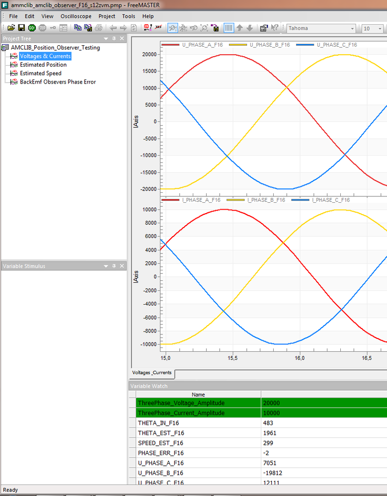

Unfortunately we are not on Matlab Software Maintenance anymore. So we can not update matlab.
I recently tried the example model: C:\Freescale\MCToolbox\amclib\ammclib_amclib_observer_F16_s12zvm.mdl (I moved to C:\Freescale\MCToolbox; because of too long name issue)
Everything works fine, I can control and compare the results with Freemaster..
For me, it seems the model "PMSM_ClosedLoop_Sensorless_S12ZVM.mdl" has some problems.
But yes, I will try your suggestion with the reinstall of the toolbox to C:\MatlabAddons\
and I let you know..
Many thanks in advance!
