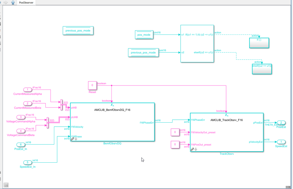

I keep trying hard to make the demo "PMSM_ClosedLoop" run, but until now without success...
Step 1:
From the original demo model, I comment out both the blocks "FOC" and "PosObserver". It builds successfully, without any errors.
Step 2:
Activate only  "PosObserver" ("FOC" commented out). Replace with blocks from lib: "AMCLIB_BemfObsrvDQ_F16" and "AMCLIB_TrackObsrv_F16" and changes names to shorter names "BemfObsrvDQ" and "TrackObsrv":
Build warnings/errors:

Step 3:
Comment out "AMCLIB_BemfObsrvDQ_F16"
Build successfully, no errors.
Do you have any ideas, what I could do?

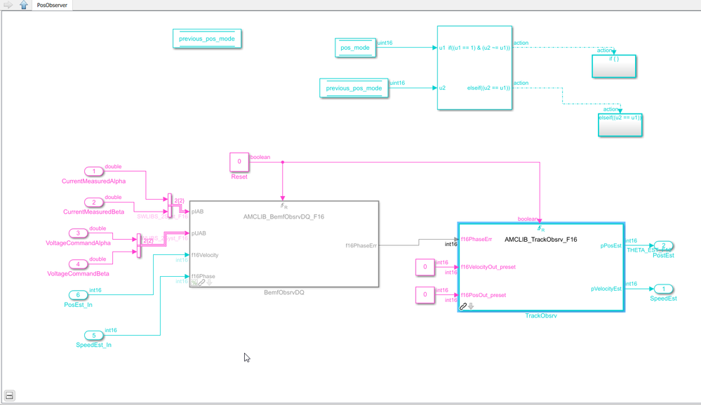

Step 1:
Because with the example model "PMSM_ClosedLoop", when I comment out both the "FOC" and " PosObserver"-Blocks, then I can build the model successfully:
Without FOC/Observer: OKWithout FOC/Observer: OK
Step 2:
Firstly activate only the "PosObserver", but remodeling with the lib-bocks: "AMCLIB_BemfObsrvDQ_F16" and "AMCLIB_TrackObsrv_F16". Name changes to shorter names: "BemfObsrvDQ" and "TrackObsrv":
Remodeling of ObserverRemodeling of Observer
Build errors:

Hi @adriantudor
I have recently tried to build the example: "\MathWorks\MATLAB Add-Ons\Toolboxes\NXP_MBDToolbox_S12ZVMx\S12ZVM_Examples\s12zvm\mc\BLDC_Demo\BLDC_ClosedLoop\BLDC_ClosedLoop_S12ZVM.mdl"
It works without any errors!
13,691 Views
adriantudor
Hi @nofake_drstrang ,
I tried to build this example on my machine and it's ok. I recommend you to copy the "PMSM_ClosedLoop"  folder on your root (eg.: C:\PMSM_ClosedLoop). Be sure that the folder copied is not protected and it can be written (check in the folder proprieties). Then add this folder to the path using Matlab, then try to build it.
Adrian

adriantudor
@nofake_drstrang  Hi,
Here is my working PMSM ZVM model.
Please let me know if this one it works for you.
Adrian
13,489 Views
nofake_drstrang
Hi @adriantudor,
many thanks!
Unfortunately it does not work
But when I comment out the FOC- and Observer- Blocks, then It works without crash.
I have Simulink/matlab 2020a. Your model is saved in R2019.
Many thanks!

adriantudor
Try to reduce the length of the names of all blocks/subsystems that are included in the FOC- and Observer- Blocks (and even the names of those 2 blocks). Unfortunately, I can't try that on my machine because I don't have this issue. And please let me know if it works.
Thank you,
Adrian
13,457 Views
nofake_drstrang
Hi @adriantudor
I tried but unfortunately it did not work. Same crash...
