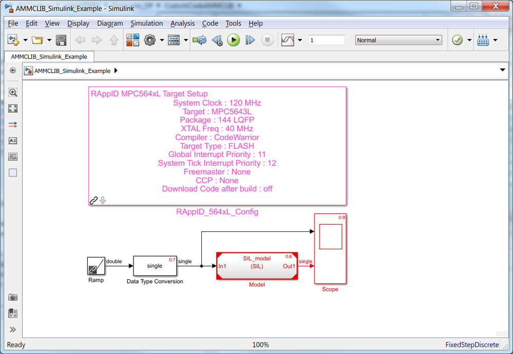

The harness model is: AMMCLIB_Simulink_Example.slx

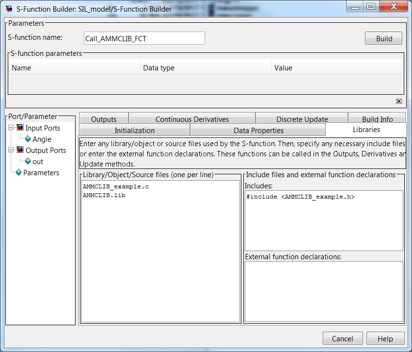

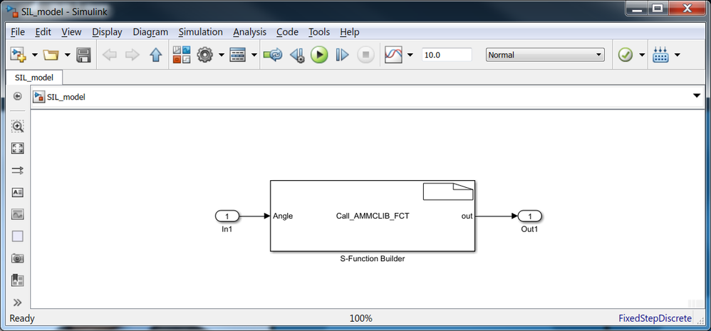

This harness model is using the SIL_model.slx that implements the S-Function

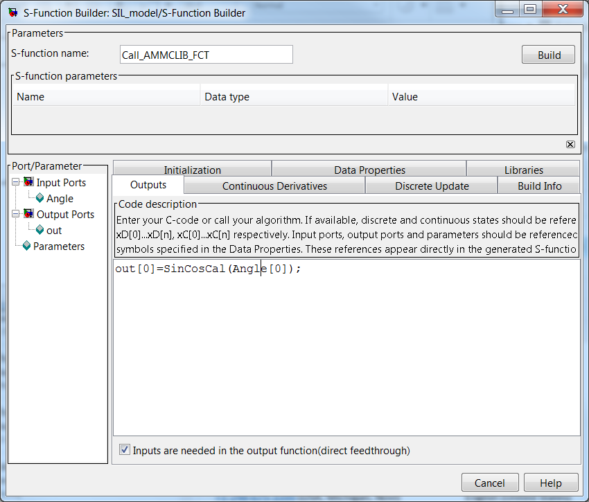

The S-Function is used to call the following function:
The function implementation is:
The SIN/COS functions implementation is within the AMMCLIB.lib that is linked with the S-Function
Ideally you will need to have the AMMCLIB source file in order to build the AMMCLIB.lib for the Microsoft SDK 7.1 compiler. Since you do not have it in source file format, you could use one of the latest toolboxes from MBDT: Model Based Design Toolbox for S32K14x Automotive MCU rev2.0 - Is NOW Available!  or Model Based Design Toolbox For Panther (MPC574xP) Family of Processors 2.0 IS NOW AVAILABLE!  to get it. It could be found under: ...\AMMCLIB_s32k14\lib\ folder precompiled for x64 or x86
For convenience you have it int he demo as x64 flavor.

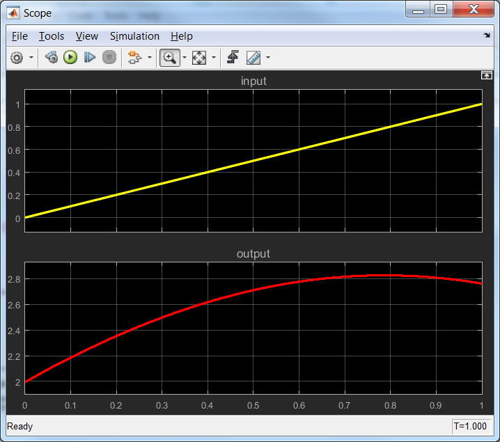

If your simple run (not build) the model attached you should expect the following results:
Hope this will help you!

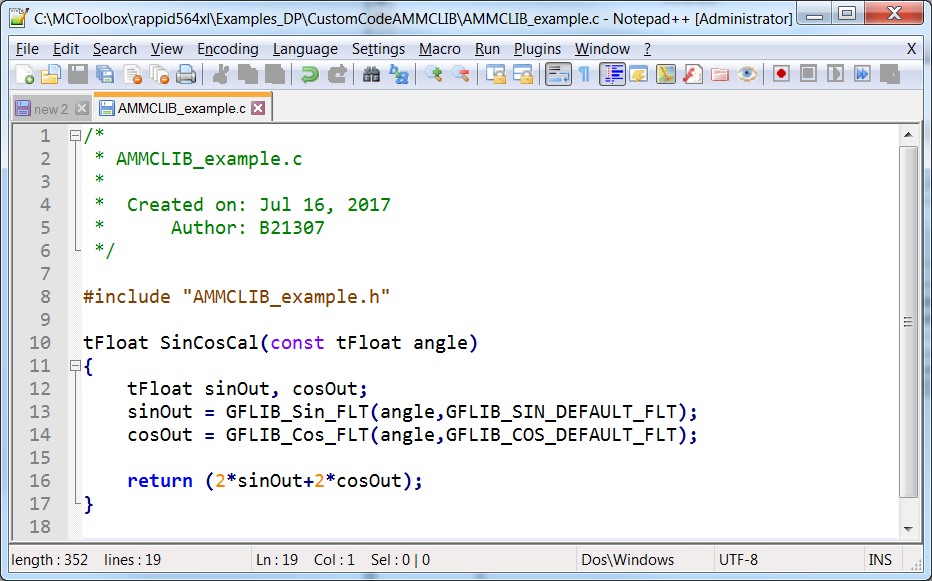

I would like to make a small correction. All of the hand written code are in C. The problem is the AMCLIB functions we use in our code.
For example, we have a function to calculate the sine and cosine of an angle input.
void SinCosCal(const tFloat angle)
tFloat sinOut, cosOut;
sinOut = GFLIB_Sin_FLT(angle,GFLIB_SIN_DEFAULT_FLT);
cosOut = GFLIB_Cos_FLT(angle,GFLIB_COS_DEFAULT_FLT);
And in matlab s-function builder, we built an s-function simply call this function. However, the s-function builder has trouble building the function due to GFLIB_Sin_FLT and GFLIB_Cos_FLT even when we includes the header files for those two functions the library setting for that s-function.
The GFLIB_Sin_FLT and GFLIB_Cos_FLT functions are from library MPC564xL_AMMCLIB.a, and that's why we think the assembly code give us trouble on compiling it on a PC.
Please let us know if you have any suggestions or further questions. Thank you very much for your help.
