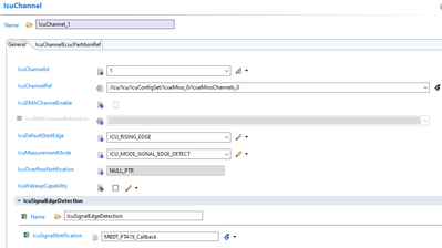

My goal is to route signals from pins to trgmux, then to LCU, then back into an Emios channel for measurements.
As part of this goal, the first step I managed to do using the example is to use a pin (PTA19) directly as EMIOS_1_EMIOS_1_CH_1_H_IN (Emios 1 channel 1 input) to trigger an interrupt on rising edge event:
This part is working for me, as the blue led is flashed when the signals is switching from low to high according to my modified Simulink model.
Now, when I try to route PTA19 through TRGMUX_TRGMUX_IN13_IN into TRGMUX_IP_OUTPUT_EMIOS1_CH1_4_IPP_IND_CH1, the same behavior is not observed.

The EB Tresos configuration is complete, in the sense that all the settings are correctly enabled for ICU, TRGMUX and for the PORT component (PTA19 configuration).

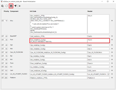

However, one additional operation must be performed in order to specify that the EMIOS1_CH1 should take its source signal from the output of TRGMUX. This should be done by setting the proper value (in this case 0110) inside the SIUL_IMCR593 register (Input Multiplexed Signal Configuration Register), as it is defined inside the IOMUX file which you could find attached to the S32K3xx MCU Family - Reference Manual. Please check the screenshot below, taken from the IOMUX file, containing the input muxing of EMIOS1_CH1.
This setting is not accessible from EB Tresos, so, to enable this connection inside our model, I would propose the following steps:

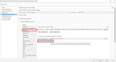

1. Open the Hardware Settings of the model
2. Open the Board Initialization sequence - here, all the peripherals, pins and clocks are initialized with the settings made in the configuration project
3. After initializing the Port component, add the IMCR register setting for EMIOS1_CH1 as illustrated below, press the Save button from the upper left side of the window and close the Board Initialization GUI.
Please note that the IMCRs defined in the IOMUX file have an offset of 512 with respect to the IMCR number defined in the SIUL2 memory map, hence the writing operation to register IMCR[81] (593 - 512 = 81).
4. Apply the settings in the Configuration Parameters by clicking the bottom right Apply button.
5. Rebuild the model
