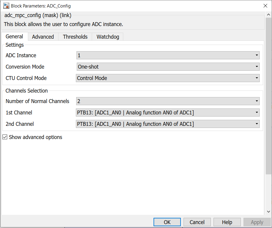

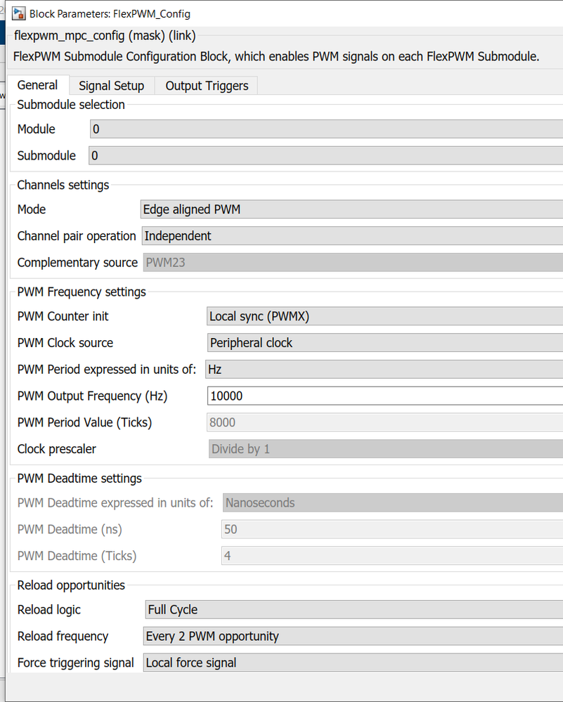

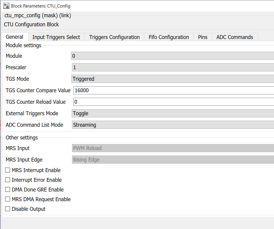

I am new to using the MDB toolbox with the SPC5744P MCU.  I am wondering what is the best reference material to use which reflects the blockset settings within the Simulink MBD toolbox.  I am currently using the 5744P reference manual but am finding that not all of the blockset settings that exist in the Simulink blocks built by NXP are described in detail in the manual.  Specifically, I am trying to learn what ALL of the settings in the blocks shown below do.  I am using Matlab 2019b, and MDBT 3.2.0.
These blocks are used in the MDBT example PWM-CTU-ADC sync example.  I would like to learn more about how to synchronize tasks using the blocks within this model.

In reference to your statement: "For our blocks, we have examples and a helpful documentation that describes a bit the settings from the block masks."
What is the "helpful documentation" that describes the settings in the block masks?  This is the key to my question.  The MATLAB help documentation does little more than illustrate the same options that can be seen from the dropdown menus of the blocks (example from FlexPWM MATLAB help documentation below).  This 'help' documentation does no act as an explanation of what the settings within the blocks do.  I would like some documentation which provides the user what the settings within the blocks do.  Where can I find this documentation?
